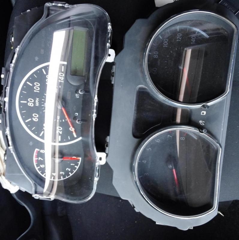

update: I got the other cluster for the swap (see pic below) and they have the exact same connection size in the back. I tried to see if it was plug & play but its not. The auto cluster receives no power so it looks like i'll have to re-pin the connection. Also the gauge cluster bezel comes apart in two pieces. The outer large piece then some kind of adapter bezel to fit. Im guessing the second piece is what's needed for the auto cluster. More pics later.

I believe the change was that the revised cluster included a tachometer but i could be wrong. The new cluster is a 2012 model going into my 2014. I ordered the pigtail connector for the 2012 cluster and will splice it into my existing harness.
The auto cluster immediate blows the "elec" fuse when connected. Updates soon to come

the 2014 versa sedan cluster is good to go, just did it finally and now I have the rpm (tach)... your mileage will be whatever came the the cluster you purchase, not your original miles... but it does work!
