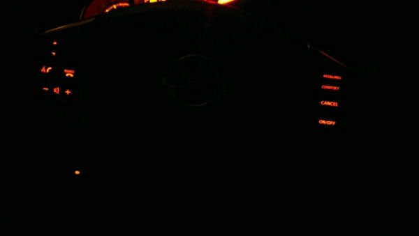

While 09 and up Vs have lighted steering wheel controls, the '07 and '08s do not. I was tired of fumbling for the stereo and cruise control buttons in the dark on my '08 hatchback, so I decided to see if I could swap mine out. The operation was a success, so I thought I would create a guide in case anyone else wanted to try. On a 1-10 scale of difficulty, I would rate this mod about a 4, mainly because of the amount of stuff you have to disassemble to get to the clockspring. The wiring itself is very simple.

Put the steering wheel and air bag back on, reconnect the battery and test the lights. If they don't come on, you have the positive and negative connections reversed. The lights are LEDs and require the correct polarity to work.
Once you're done, put everything back together and enjoy your lighted controls. They will come on with the headlights and are dimmable.
