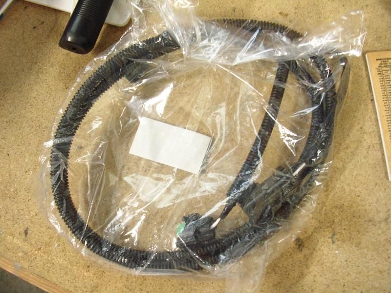

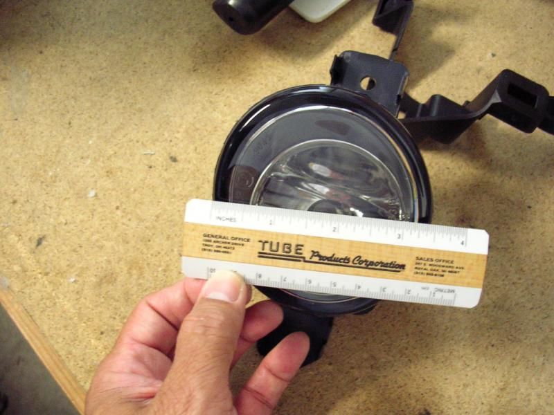

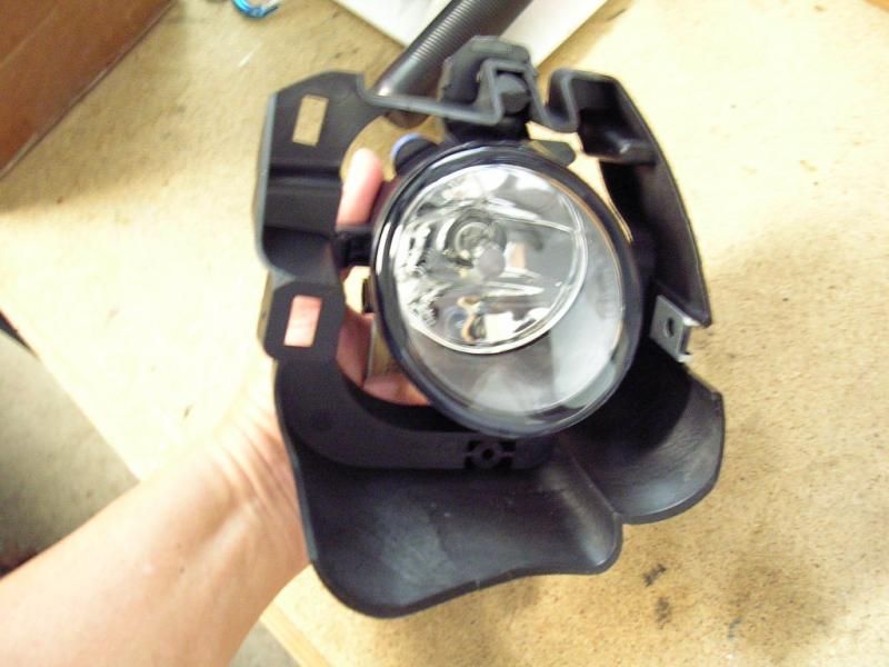

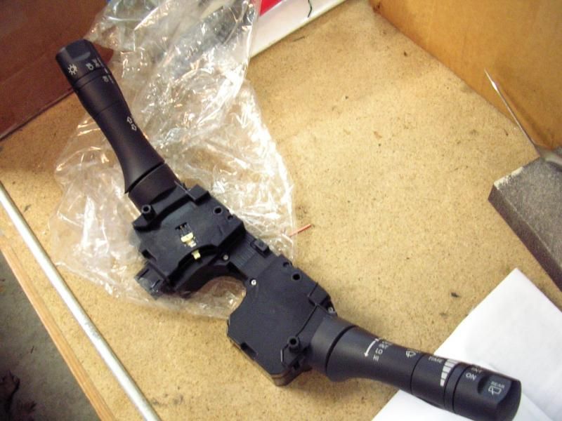

since you bought this kit from amazon what came in the kit? the description for the product is non existent... thank you
i'll try to take a pic for you of what is included tomorrow... package came last week but been busy with other stuff
that would be great if you could provide a pic, thank you
Here are some pics of the package.
thanks for the pics.. perfect, you have convinced me to order a set for my wife...

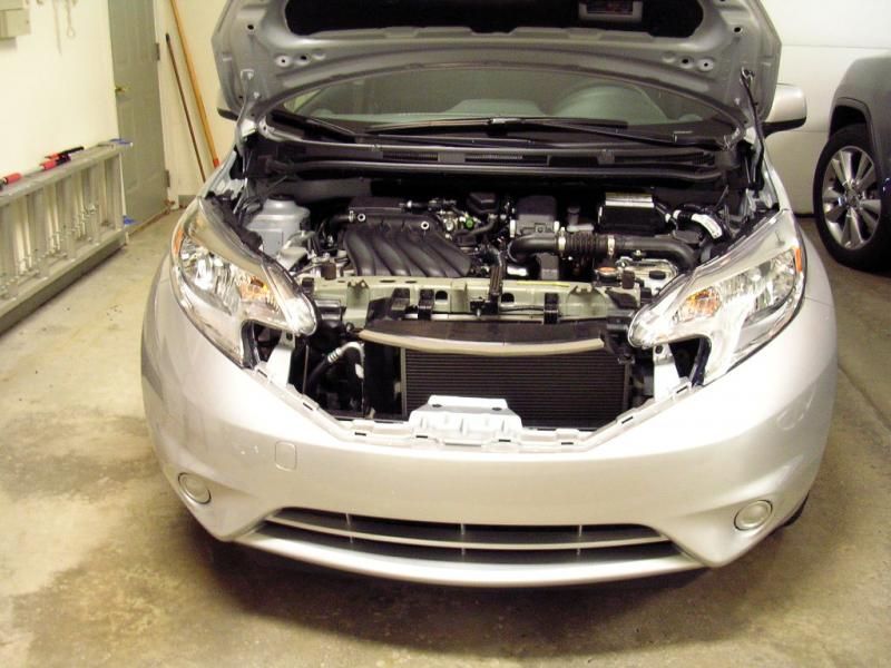

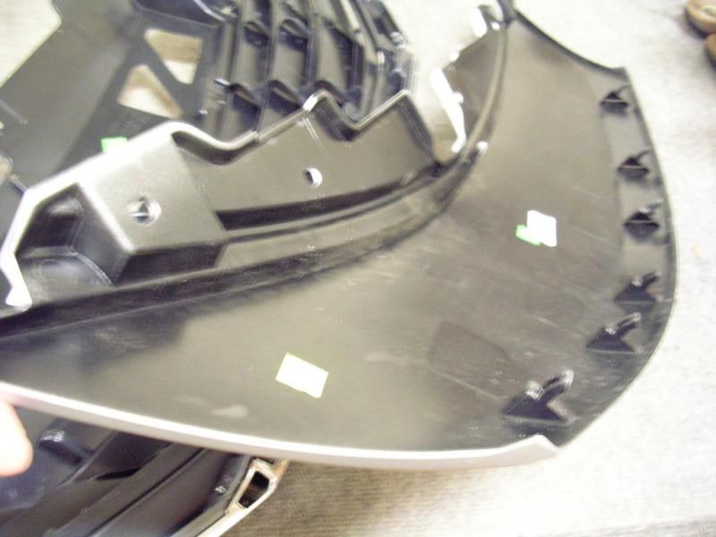

So I finally found the time to install my Fog Lamp Kit (PN 999L1-4Z000) and boy what an ordeal. I must be getting old for this. I guess it wasn't all that bad only two broken tabs, a small cut on one hand, and a whole bunch of scratches on my arms.

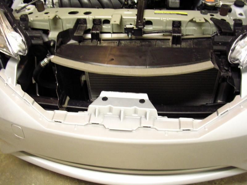

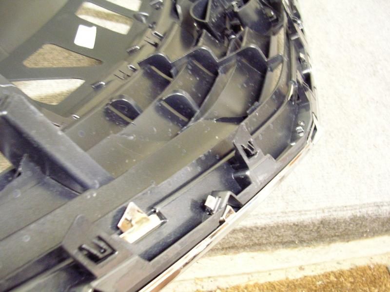

Since most of the body parts are just snapped together, this was the most difficult part of the project, not knowing if you are going to break anything while you pull things apart. It took a lot of patience to get it done.
The Nissan PDF instructions I found from the web were not too descriptive and in most cases the car is not symmetrical. Accessibility on the right side was much easier than on the left.

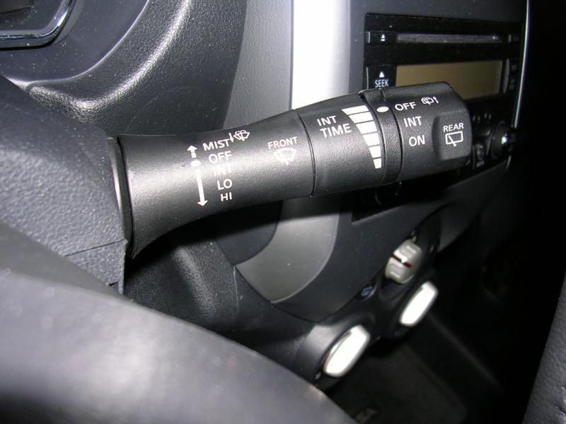

Overall, it turned out great, even got a surprise new feature for my wipers.
TOOK ME OVER 3 HOURS JUST TO GET TO THIS POINT
BACK SIDE OF RADIATOR FRONT COVER
BACK SIDE OF GRILL

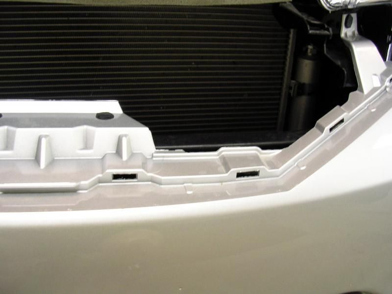

CLOSE UP OF GRILL ATTACHING POINTS ON BUMPER

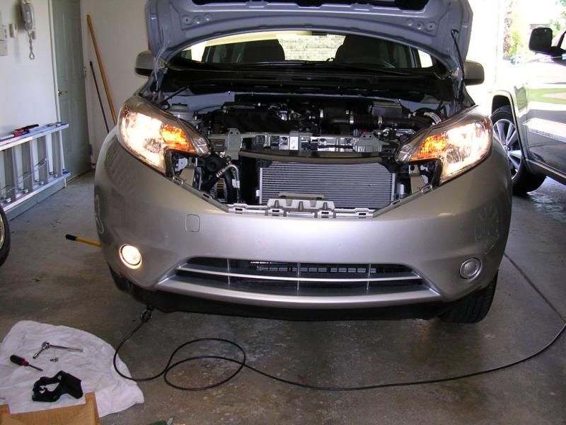

RIGHT SIDE DONE
BOTH SIDES DONE, GRILL REINSTALLED
As I mentioned in another posting, the kit came with Variable Time Intermittent Wiper Feature which I was not expecting at all.
