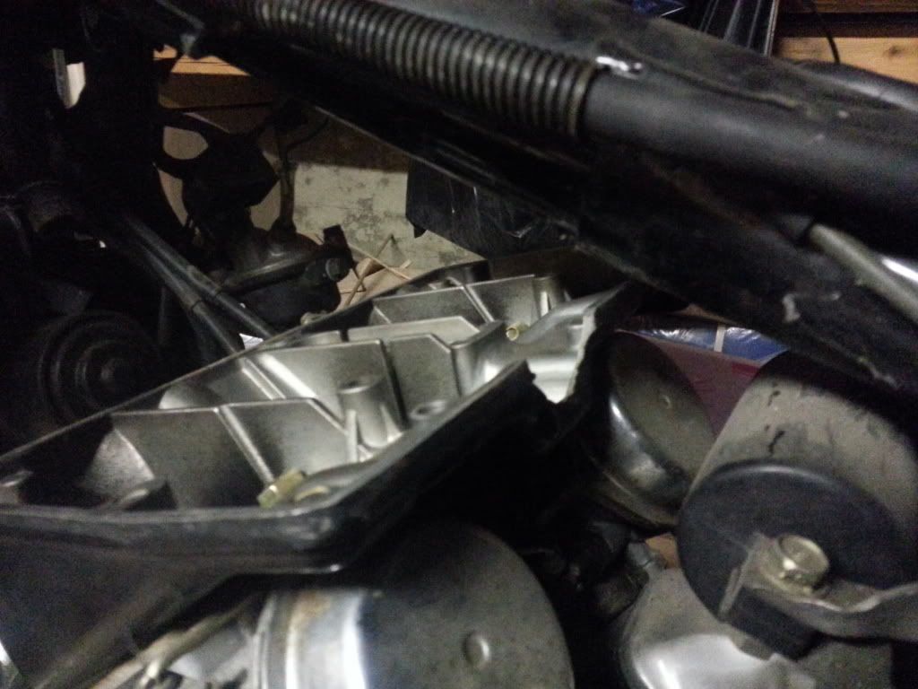

I got the airbox off today. Came right out with a bit of pulling. Discovered 2 things.
1: I'm no expert but I'm pretty sure this isn't supposed to look like this:
I don't even know how that happens... It was patched with ELECTRICAL TAPE. somebody painted the whole thing black so it would be less noticeable I guess. Could this be why my carbs are gummed up? Some nasty dirty air got sucked in there? Possibly, but it's more likely from this:

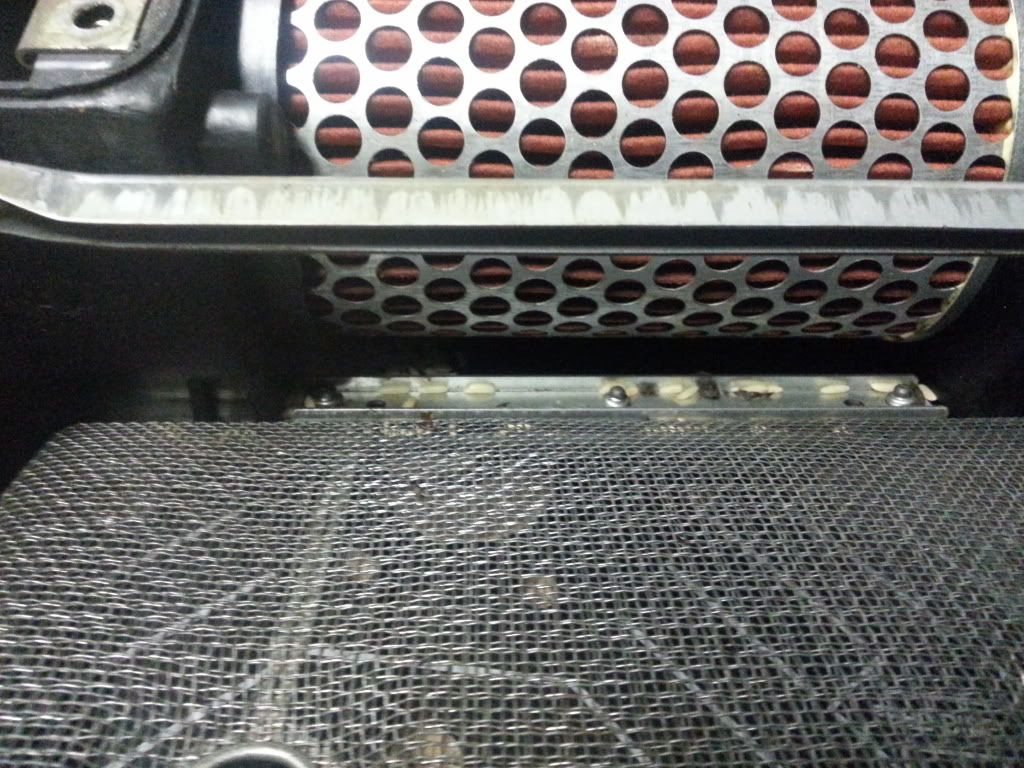

I found enough rice and corn in there for a small meal. And let's not forget all the mouse s***. This is more than likely why my carbs are screwed up. They're full of produce! The mouse made a nice little home in the air filter. Definitely taking the carbs apart. Going to purchase a rebuild kit hopefully in the next couple weeks along with a new lower airbox I found on ebay. Anyways that was all I really got around too today. I have a nice little to do list building up now. haha

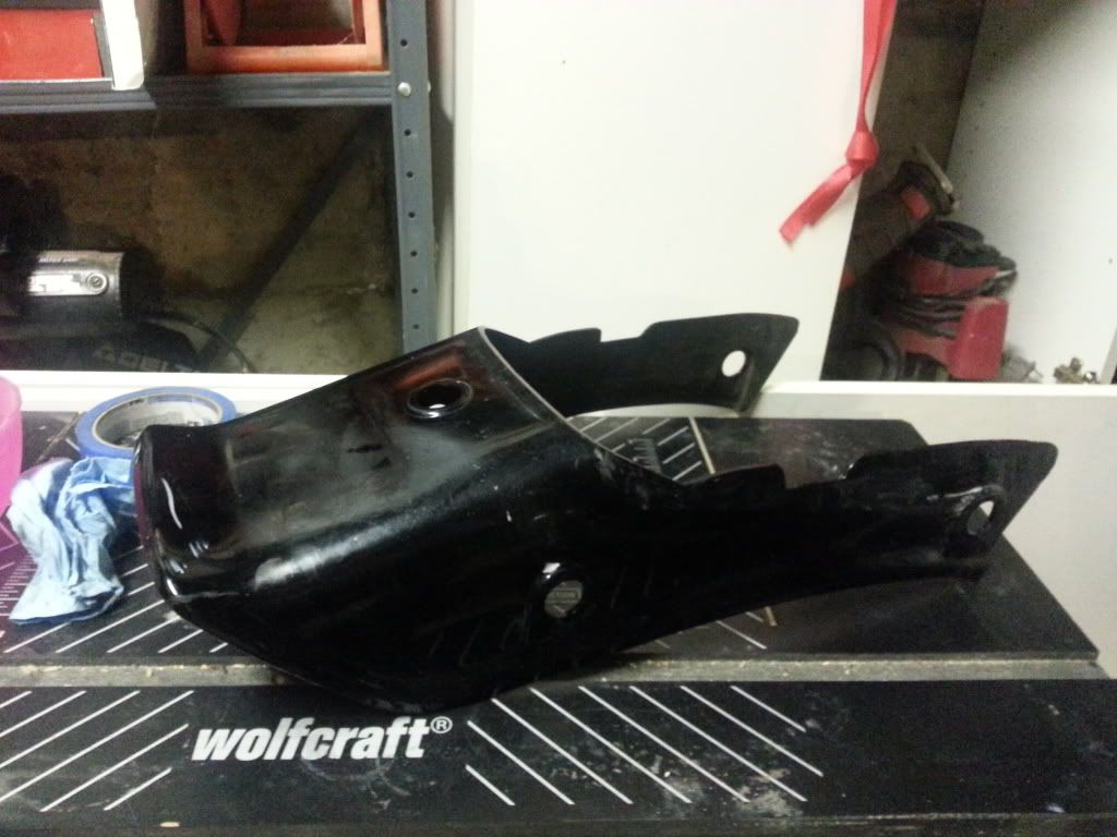

Started some painting today. Still unsure of colors. Here's the before:

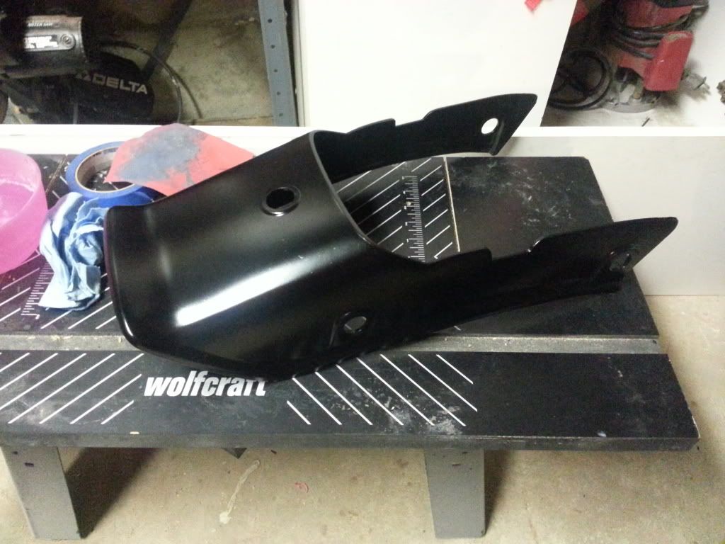

And after a few coats of satin black:
Didn't bother filling in the scratches with any body filler as most of them will be covered up by other pieces and I didn't want to spend extra hours on it when I have plenty of other things to do. Plus its not like this is a show bike or anything.
