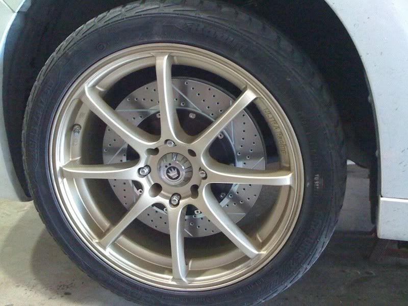

So my calipers dont clear... I had a feeling it wouldn't but you never untill you try...
So I think I need some wheels that have a higher offset?

have you tried spacers? could get you the same results with less investment.
If I did spacers I would need atleast a 10mm spacer with extended lugs...then I would need to match the rears so I want a different look anyway might as well go for a better set of wheels.
do you have stainless steel lines and better pads already?
Why go for a bigger kit? You running AutoX?
The Rotora Big Brake kit is equipped with the better pads and Front/Rear stainless lines... I don't know if I'll go into Auto-X I just want to prep myself for the upcoming SuperCharger
pretty sure all you need to clear these are a +36 or lower offset
Yeah Im leaning towards Rota Torque 17x8 35mm offset
