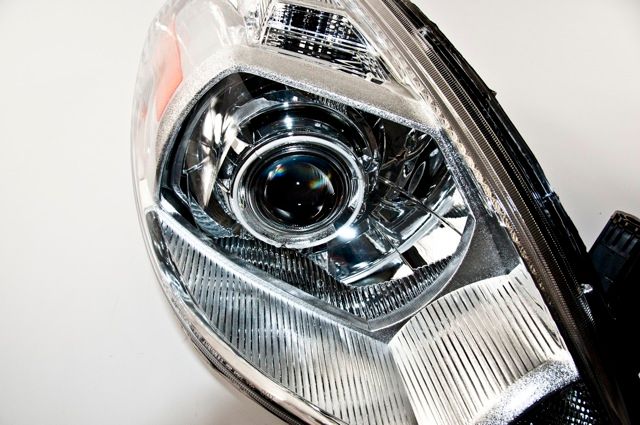

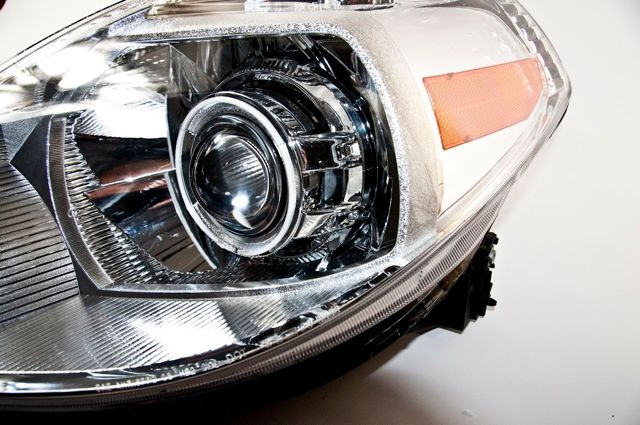

Well I was tired of my halogen headlamps and I wanted projectors. I heard about the "ebay" projectors and over time read iffy reviews. Then I thought about the JDM projectors but I didn't want to deal with wiring even though there is a how to.
SoOo....
I went online and found a company Lightwerkz.net that does custom projectors and after 22 emails back and forth this is the finished project.
Enjoy:
You can read more about it here: http://www.lightwerkz.net/news/?p=311

It doesn't list a price on there anywhere. Based on what their price list shows and the write-up saying how difficult it was to get them right, I'd say you spent upwards of $800 for the whole kit and labor?
They look great. I can't wait to see them on your car and how they function compared to my JDM Bi-Xenon projectors.
545 Posts
I should get them maybe monday or tuesday. Then I'll find time to put them on and snap some pics for you guys.
This is something that won't be mass produced and will only be made upon serious request and can be customized as much as you want. Just contact Ceasar and he will make it happen.
Since these are custom made you do have to pay to play: $1300

i know a guy who owns a Yaris sedan and he installed projectors from a S2000 into his headlights... ill see if i can find a picture... i think you over payed for this whole setup, i have seen how to cut your headlights to black out the housing, why not black out the housing and install some projectors at the same time? just a thought... post pics already! lol
4,543 Posts
^^^ That would be great. I would do both at the same time but I tried opening the headlights and couldn't. I'd like to try it following the steps on NICO but opening them with a dremel would be dangerous.
1,848 Posts
1300 is a lil steep for some headlights but they do look really good tho. To each it's own, that's what I always say.
those look great but lil too much $$ for me. I def would have bought JDM projectors and spent $30 on a plug n play harness. Should have had them remove the amber reflector since they were already in the headlight.

What can I say, these were a challenge. At first the OEM lights arrived and the lens would not budge no matter what we did. We had Martin order up a set of aftermarkets since we were all determined to get this done. The aftermarket lights came and looked promising, but it was also a less than favorable type of sealant. The lights were able to be opened but required the sealant to be removed and replaced with OEM Nissan Butyl sealer. We added screws to the side of the housings since the lights had no tabs or screws holding the lens tightly to the back housing.
I would not have been happy with this.
I am tearing my headlights apart, blacking out the whole thing and mounting some FX35 projectors in i have sitting around. Much cheaper if you have access to cheap/free projectors
Did you take a Versa headlight apart yet? I have heard several stories in including the one in this thread that they do not come apart. They need to be cut open and glued back together. It's not a matter of putting it in the oven like all other headlights. I wish you the best of luck though. I hope it works out for you and if it does make a howto for other people.
