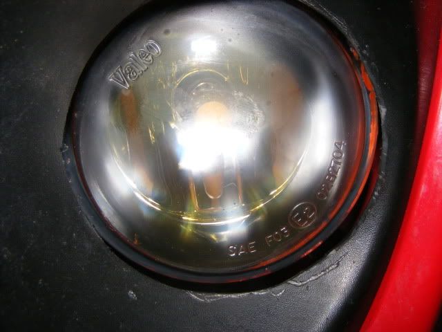

The factory wires were there for the fogs. I needed a new turn stalk and bulbs for $120. Plugged it all in and it works. I hope the silicone works.
To those that have factory or OEM fogs do they say Valeo on the lens?

The ones I bought from bob say Valeo on them. But I didnt go thru what ur going thru.

If you got the power package, (windows, door locks) then your car is pre-wired for fogs. To get the OEM experience, you would need to purchase the turn stalk w/ fogs, the fogs themselves and the plastic housing. You will find all the appropriate connections when you start digging.
No power package? No pre-wire, and you will need the whole kit. This runs about 260-280 dollars depending on what site you purchase them from.
Hope this helps.
