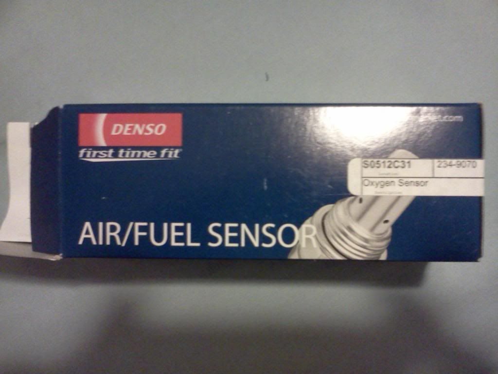

I ordered the replacement O2 sensor and got it for $87 as well as same brand that the stock one was. DENSO. Whenever that comes in I'll go and pull out the straight pipe and put it in as well as seal in the connected part. There's still a very small leak but it's nothing like it was before so the sound went way down which is good, kind of too loud in the cabin.

Back to the OBX topic:
The sensor came in yesterday from AUTOPARTS WEARHOUSE
The install will be probably this weekend hopefully along with the sealing of the straight pipe and stock exhaust catback.
321 Posts
Discussion Starter · #36 ·
Update:
False alarm, autoparts wear house doesn't sell the correct fuel sensor. I talked to them for a good 25 minutes and ended up not having the correct part listed in the catalog so don't go buying a header O2 sensor from these guys. Do your research throughly before purchasing.
I haven't gotten time to buy a new one. I'll probably end up getting it from nissan directly to avoid any more mistakes. Still having an exhaust leak :/ Maybe will be finally fixed around next week who knows
