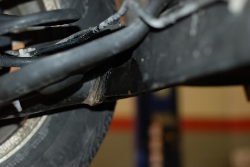

Got my car up on a hoist and these are the two pictures I took. Its evident that the beam is bent and needs replacing. He also recommended I change the wheel bearing as it's likely damaged. I managed to find instructions on how to replace the beam but it looks like a lot of work. Going to e-mail my local wreckers to see if they are cheaper then the dealership.

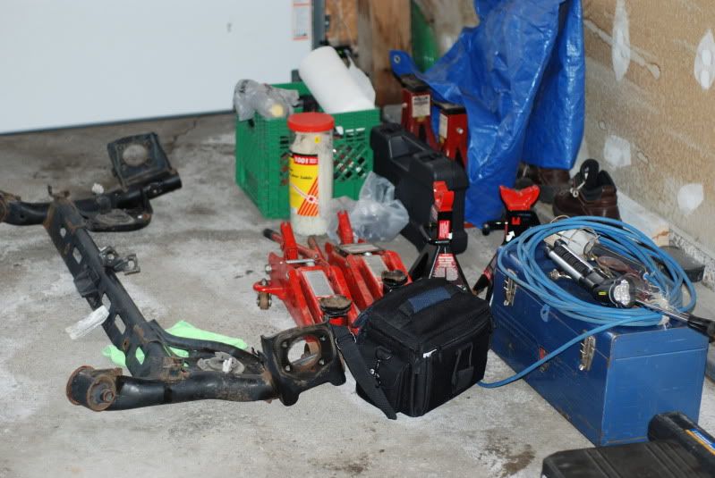

So I changed the axle out last weekend and replaced the bearings the next day as they started to scream murder. Out of 10 the level of difficulty was about 6.5. Here are some pictures from the job
Below you can see the bent under the bracket

It's definitely a great achievement since everything worked out so nicely. After the incident my steering wheel was pulling to the left, now its straight again :). Really surprised how much the rear can affect the steering column.
