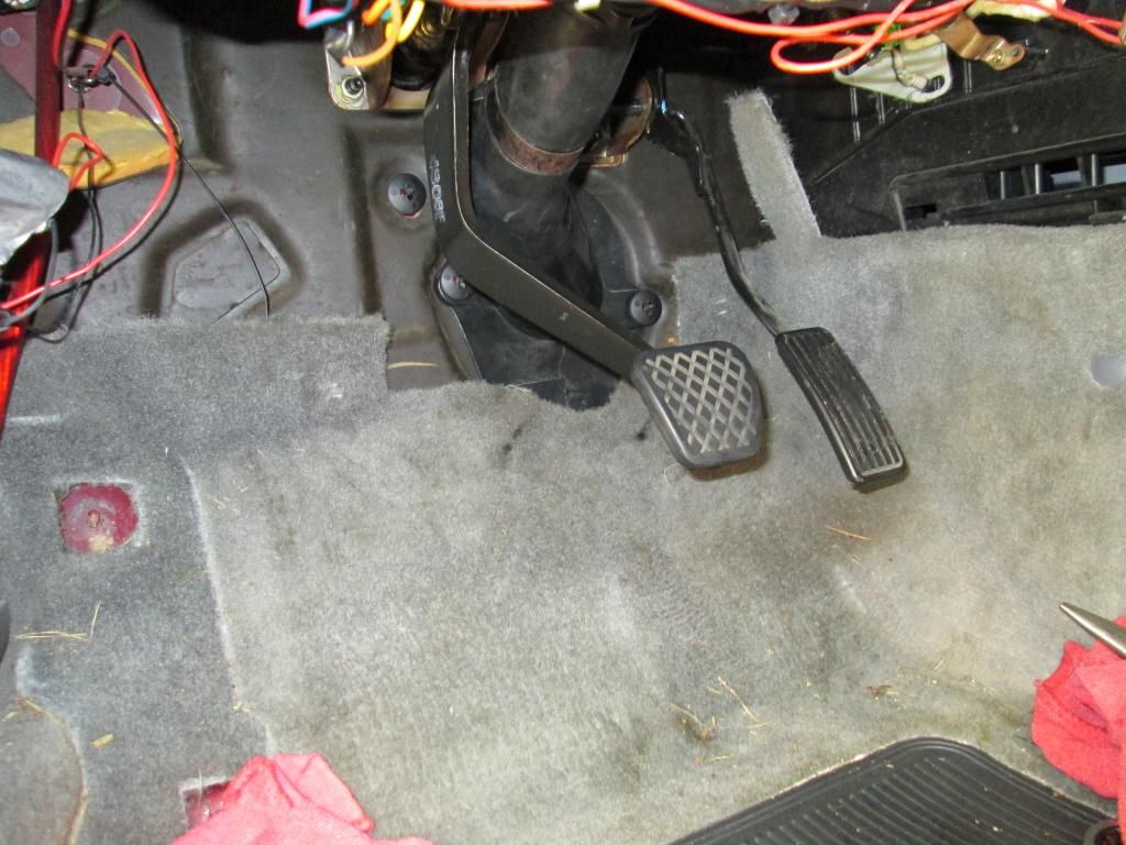

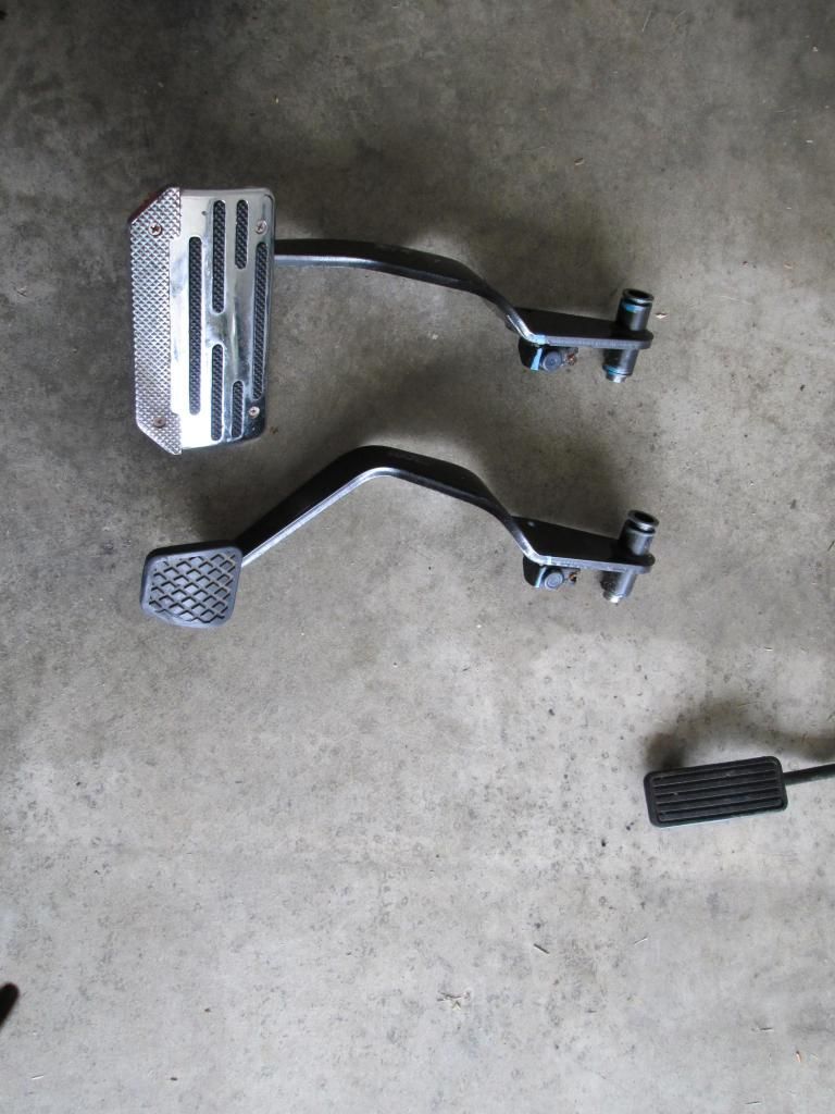

First thing I did was to go ahead and get the actual pedals swapped for the conversion.
Auto brake pedal removed
Manual brake pedal installed. This was possibly the most irritating part of the whole conversion. If requires you to be upside down with little room to move at all. Once you get the brake pedal in, you then have to blindly use a pair of needle nose pliers and try to hook the spring onto the new pedal. This of course is after you either hook the pedal but the spring comes off the car or the spring just falls on the floor which requires you to get out of the car, find it, and then get back in upside down to start over.

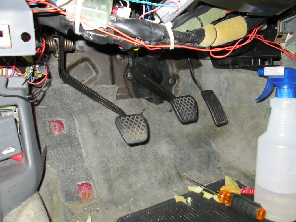

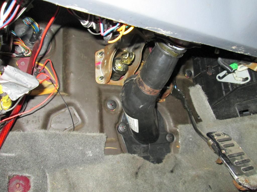

Next up is to install the clutch master cylinder along with the clutch pedal assembly. Ignore the wiring mess....it is on my to do list to be cleaned up.

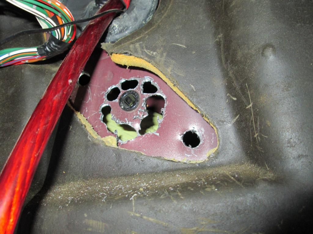

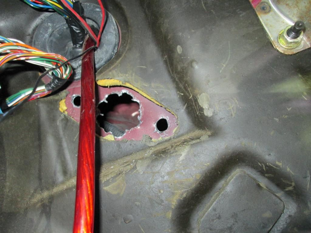

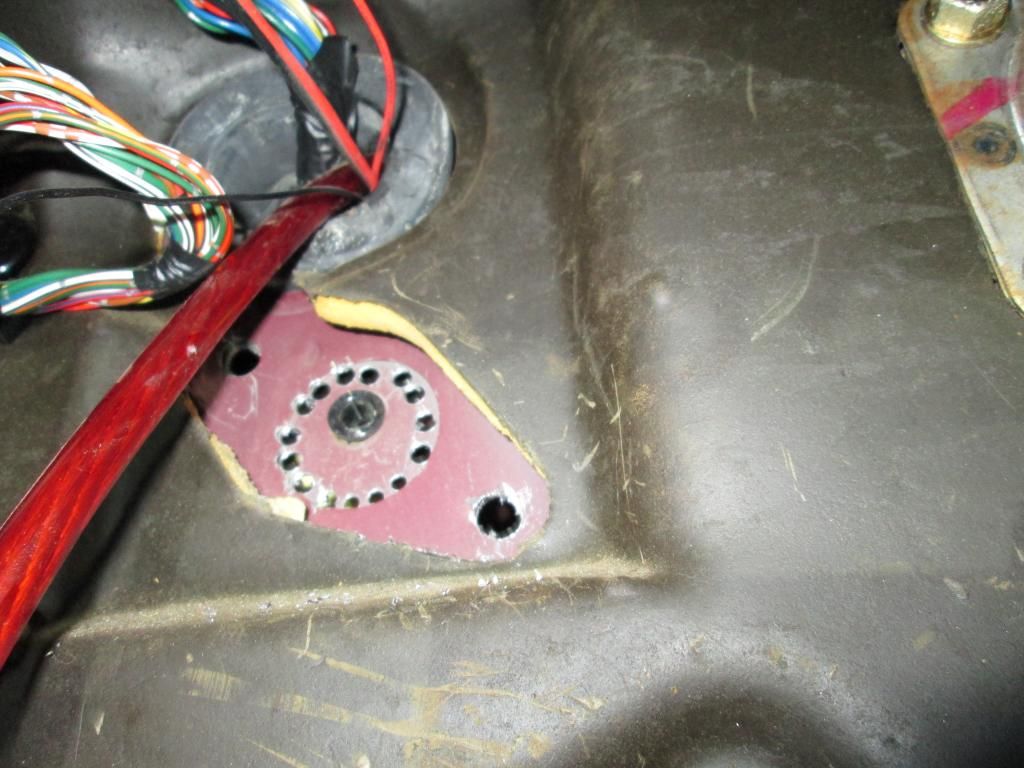

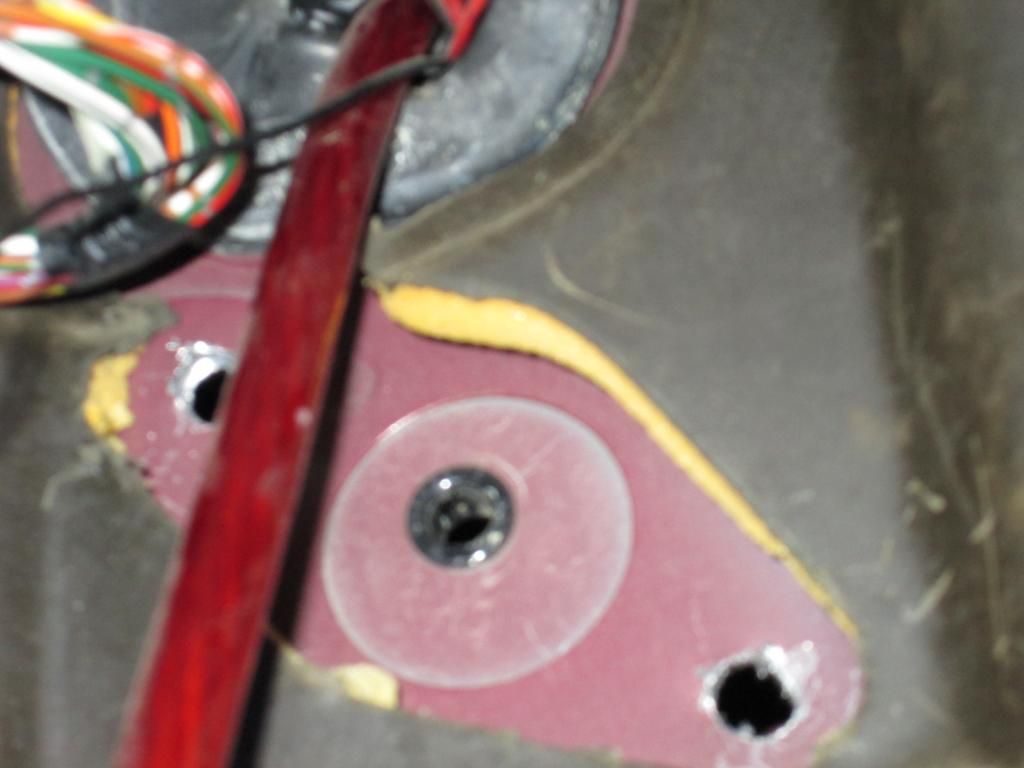

I didnt have a hole saw so as you can see I had to drill quite a few small holes and then punch it out.
I then smoothed it out and sprayed it down with a zinc rich primer to prevent rust on the exposed medal. Here, I was able to get the master cylinder in and avoid any sort of cutting or tears. 2 spacers need to be added on the studs.

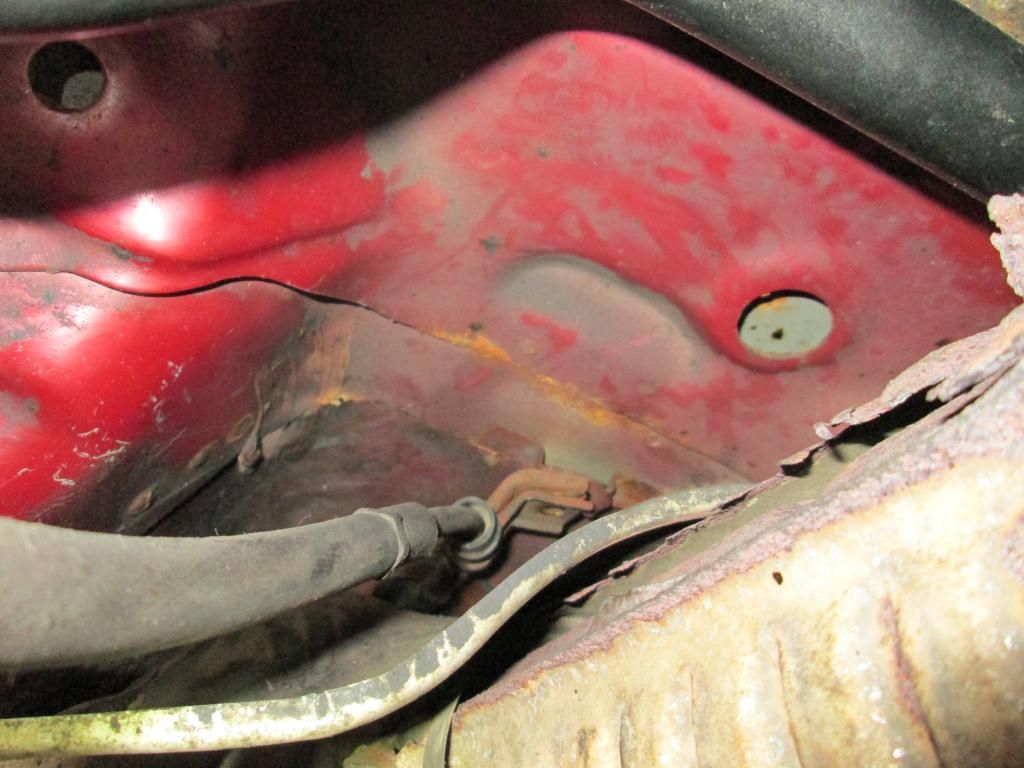

This is looking straight up underneath the dashboard and is directly below the cowl and windshield wiper motor. Here you have to drill a hole to line up with the assembly for a bolt to help secure it and prevent the clutch pedal assembly from bending when used. It was more difficult because people who remove the wiper motors and arms have a hell of a time installing them correctly again. They have issues of the wipers ramming against the side of the windshield and destroying the motors/wiper plastic bushings. I dont think I took a picture but the bolt was tucked back in the cowl and could only be accessed by long pliers.
Installed! This too took quite a bit of time to get everything positioned up correctly and would have helped had I had a second person.

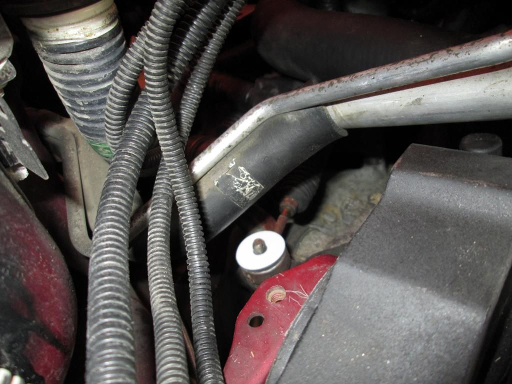

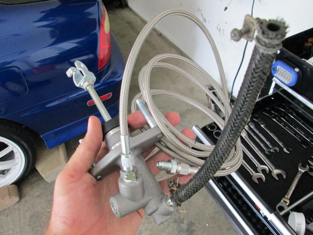

Here is the master cylinder. I ordered a custom $80 stainless steel line from Bonaco that goes directly from the master cylinder to the slave cylinder. This save a TON of time and headaches by avoiding Hondas original dampener system.

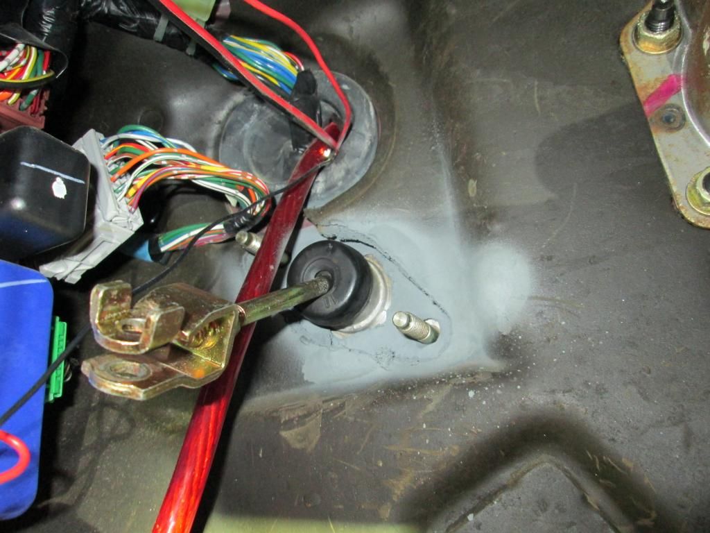

Now to remove the auto shifter assembly.
Removed. Now I have access to the auto shifter linkage
Adios!

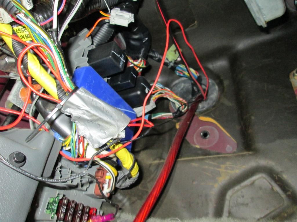

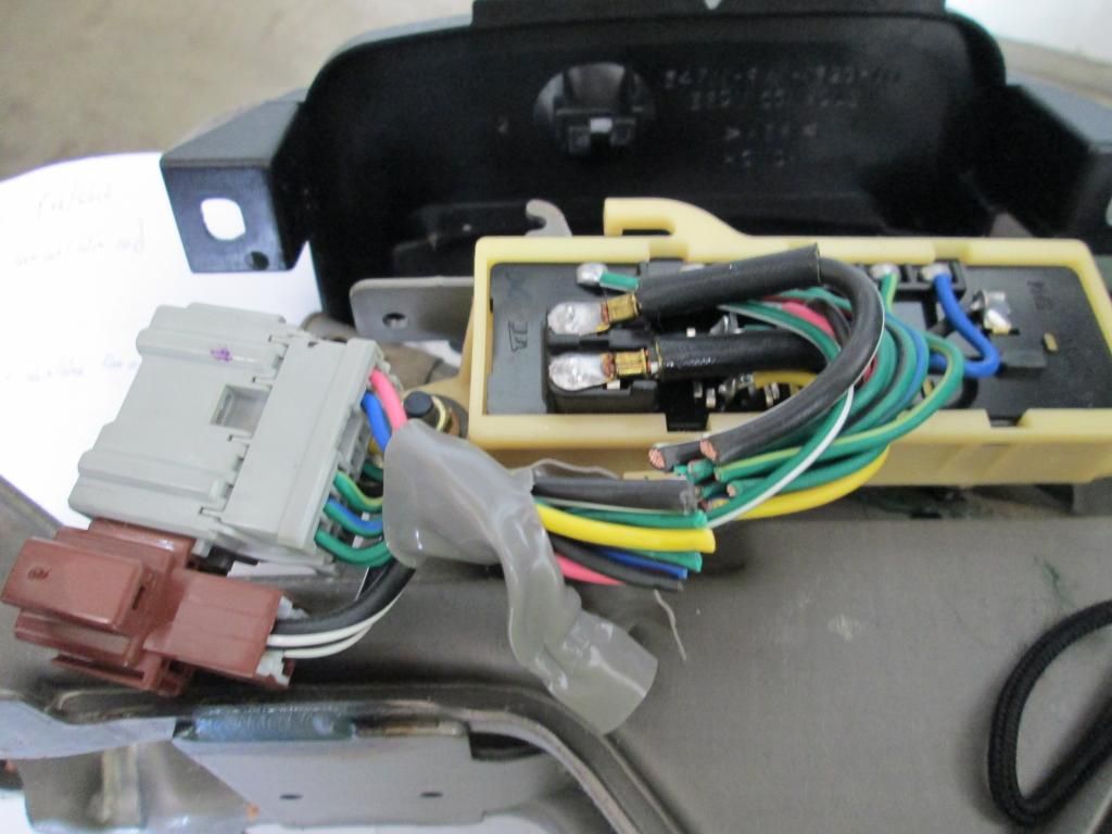

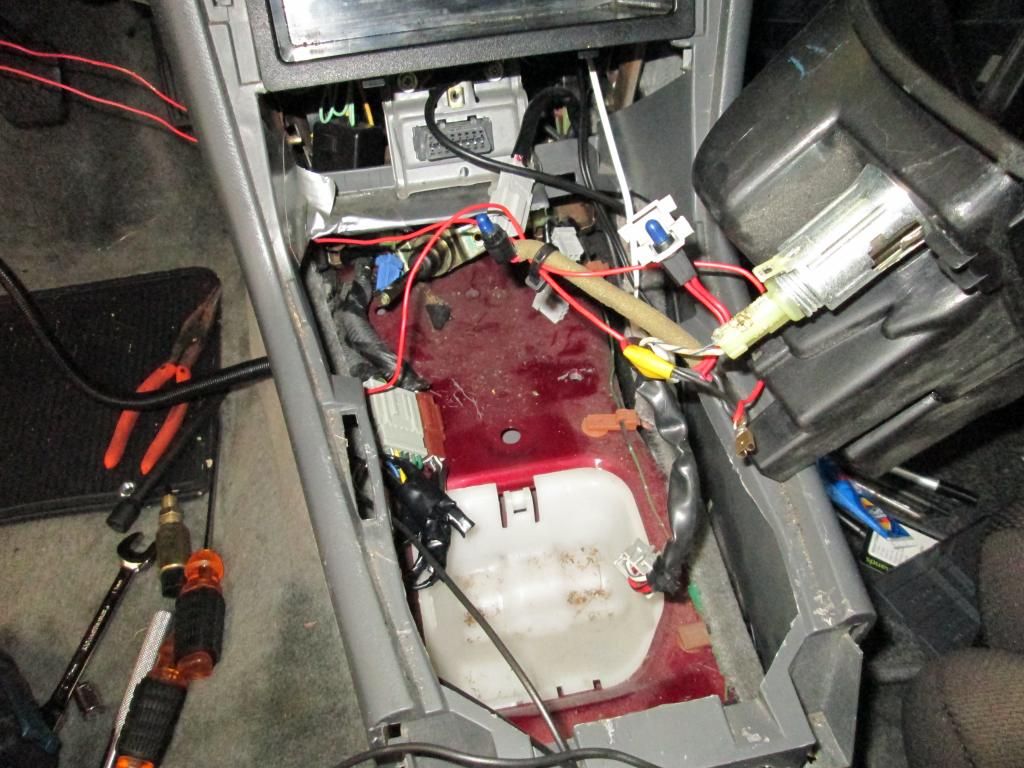

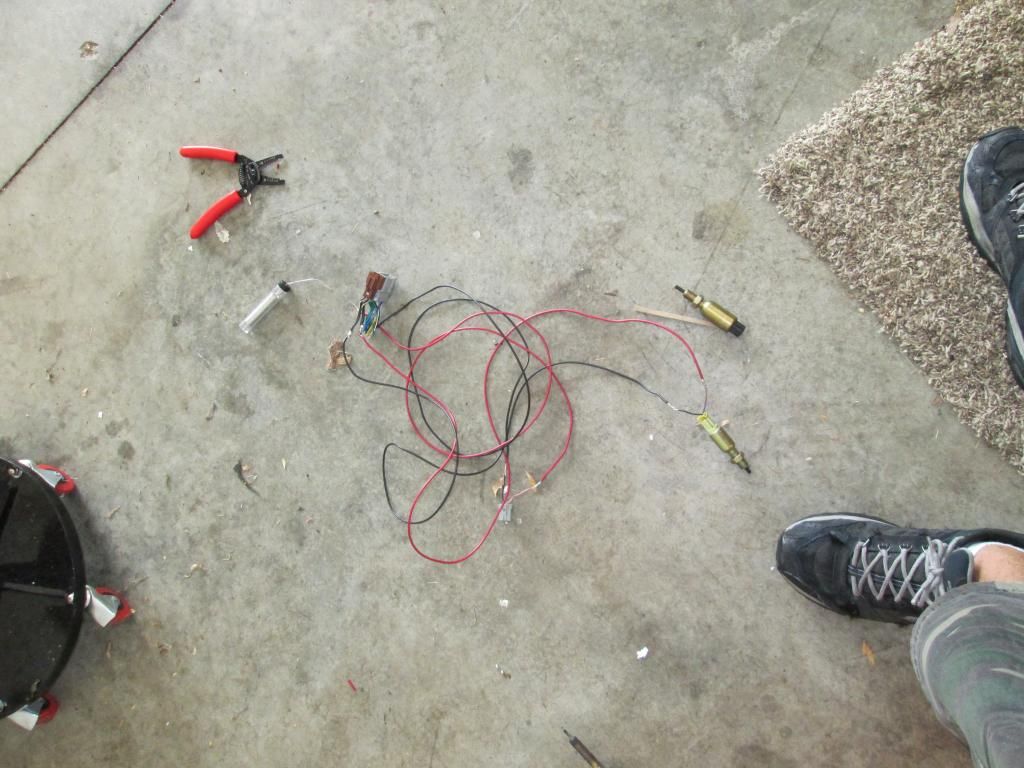

After removal, you need to save the plug to wire up the clutch safety switch and cruise control along with a couple other things.
Everything wired up correctly
Now to get the wiring over to the clutch pedal

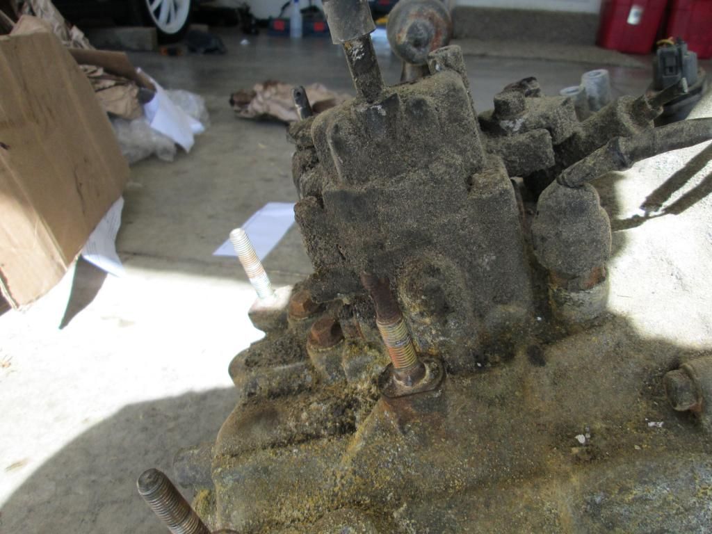

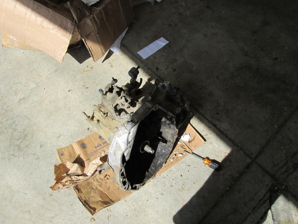

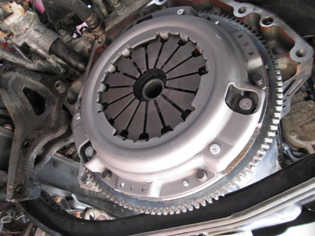

Transmission arrived in "lovely" shape. According to the salvage yard, it only had 82k miles!!!

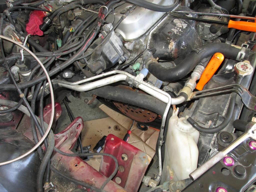

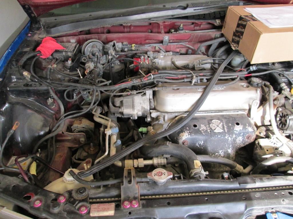

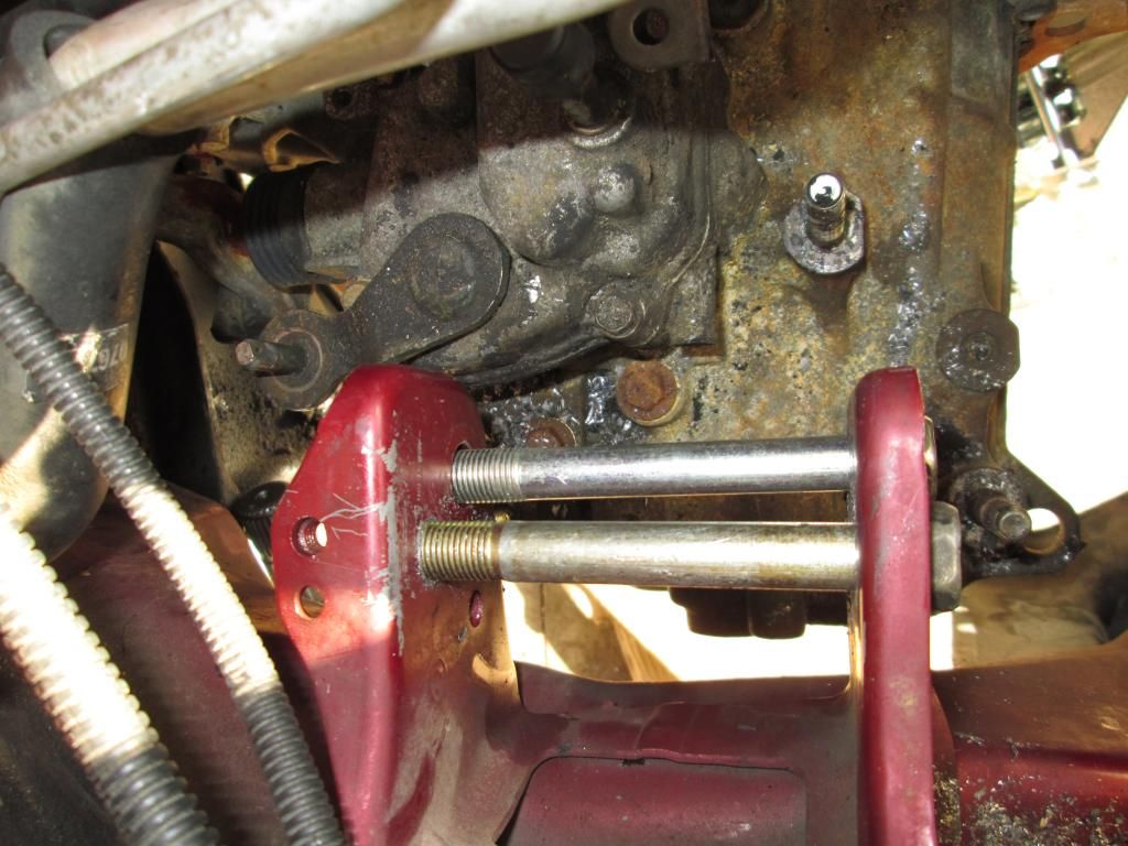

Heres where the heart of the beast resides! So far the strut bar, intake, battery, cables, and the starter have been removed.

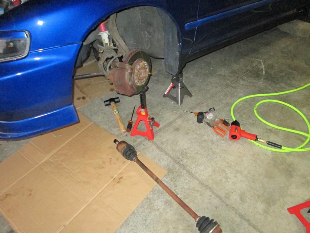

Sacrificed a screwdriver for the axle nut.

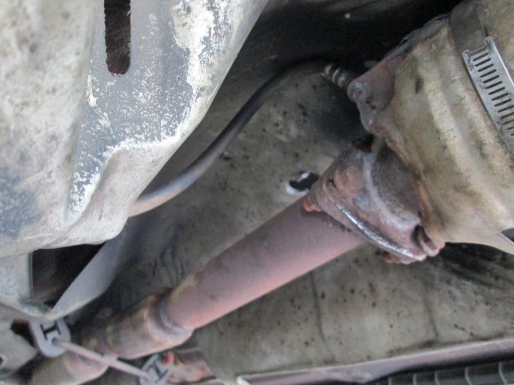

Instead of removing the exhaust to get some bolts needed to remove the shift linakage way back in there. I just went ahead and drilled a couple holes big enough to get a socket in.

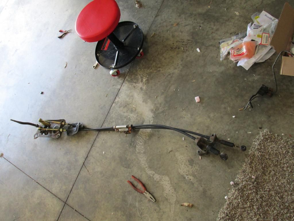

Manual shifter linakge

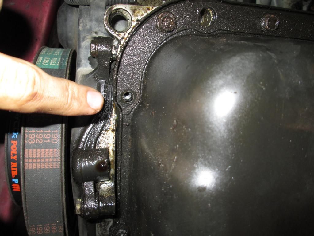

Oil pan was leaking so I had a Honda Tech replace it with HondaBond. However, when I started the car it started pissing out oil. Went ahead and got a new oil pan and OEM oil pan gasket. We also replaced the rear main seal during the swap.
Transmission is out! However, we did miss a bolt and took a small chunk out out the auto tranny case. Oh well.

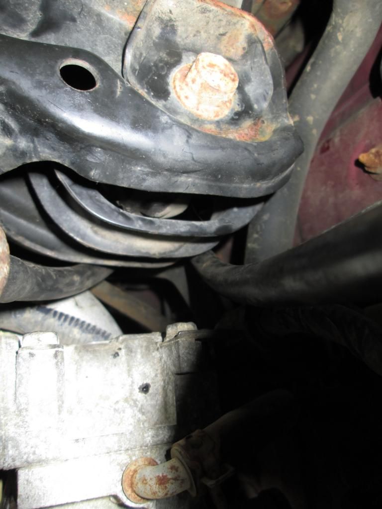

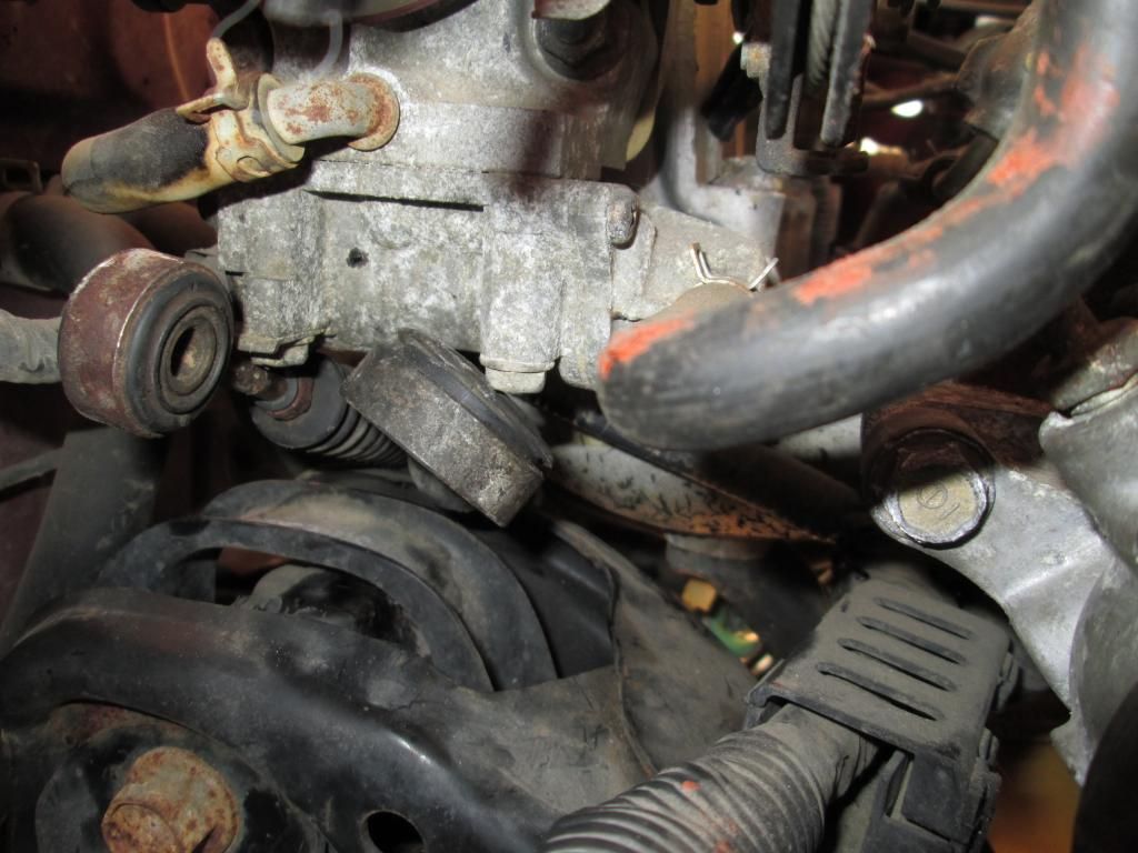

Here you have to drill a new hole for the manual transmission motor mount. If you reuse the auto bolt location it will cause the axle to bind and will need to be replaced every couple of weeks. NO store carried a 12mm drill bit, this biggest was 11mm so I had to order one of of Amazon. Then as soon as I got one hole drilled out, the bit broke.

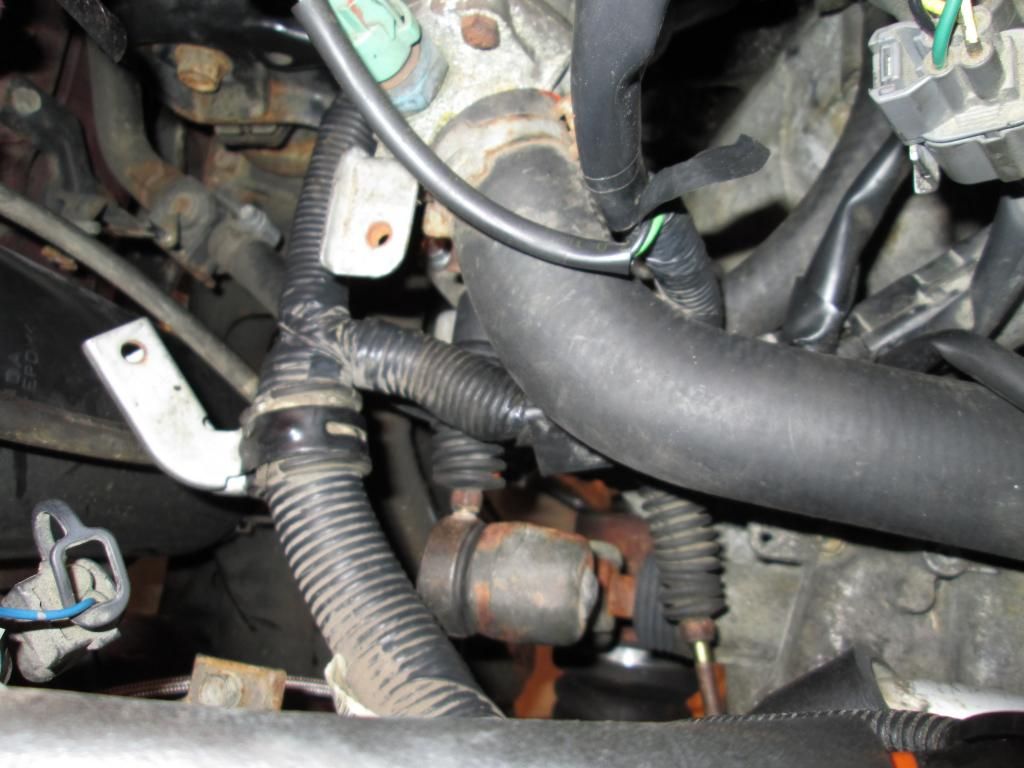

This was another headache. Routing the manual shifter cables and trying to get them connected to the bracket along with the C clips when you can even get your hands down there! The main issue is that the rear motor mount for an automatic is quite a bit bigger than the manual version. Because of this you really have to keep trying over and over to find the most efficient way to route the cables and gain any millimeters that you can.
Very little room for the cables
