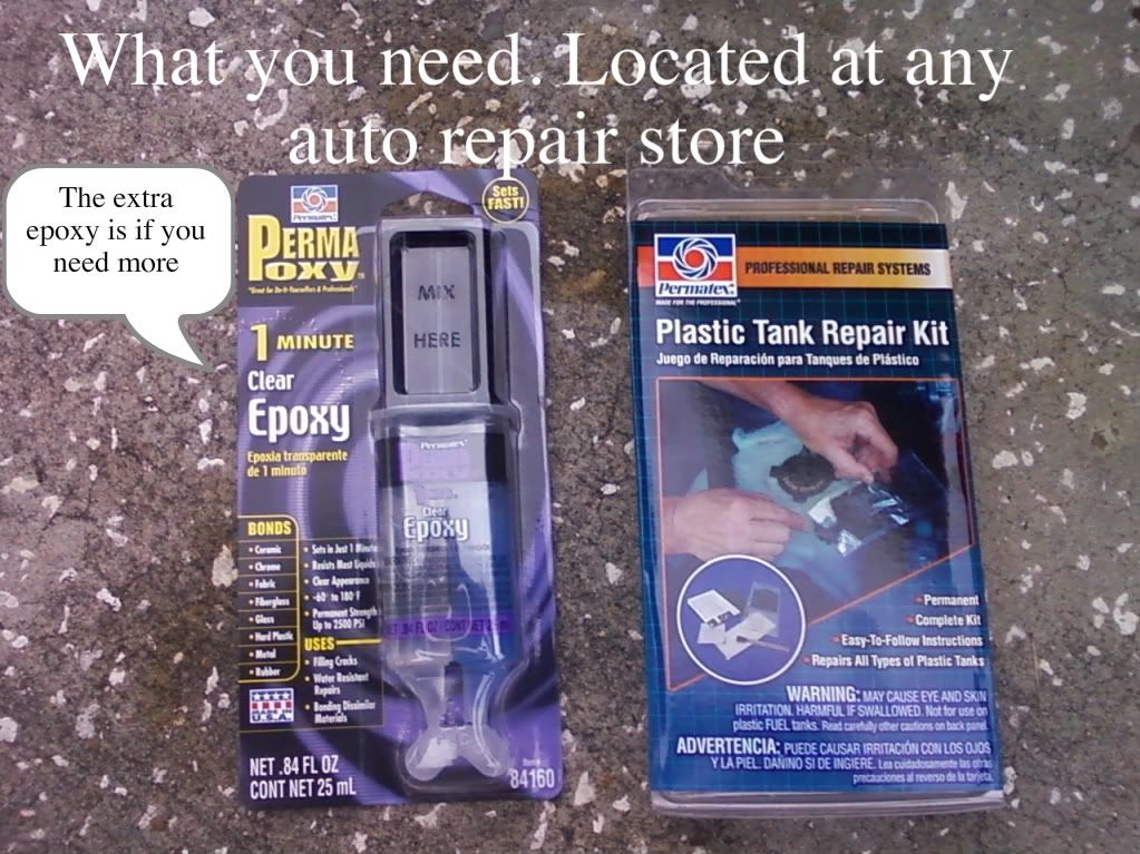

Heres what you need
Epoxy about $6
Repair Kit about $12
Heres the actual instructions the repair kit comes with.
