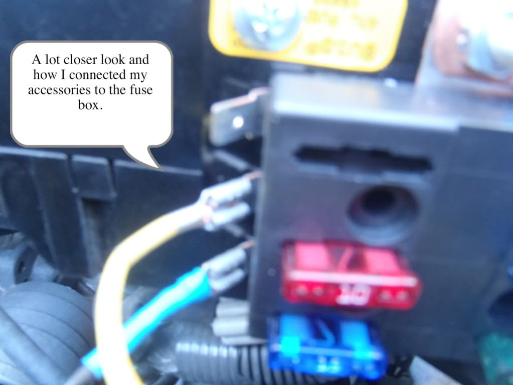

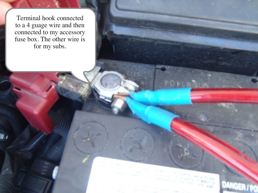

Some people were asking how I installed my accessory fuse box so here is a how to. If any questions I will be more then happy to help.
What you need:
1. the actual fuse box (I bought it at auto zone, but I also seen it at discount auto parts. I dont know about PepBoys.)
2. 2 terminal hooks (Also at auto zone)
3. 4 or 8 guage wire (The bigger the better. Allows better power flow to your accessories)
4. screws
5. electrical tape or heat shrink tubing
