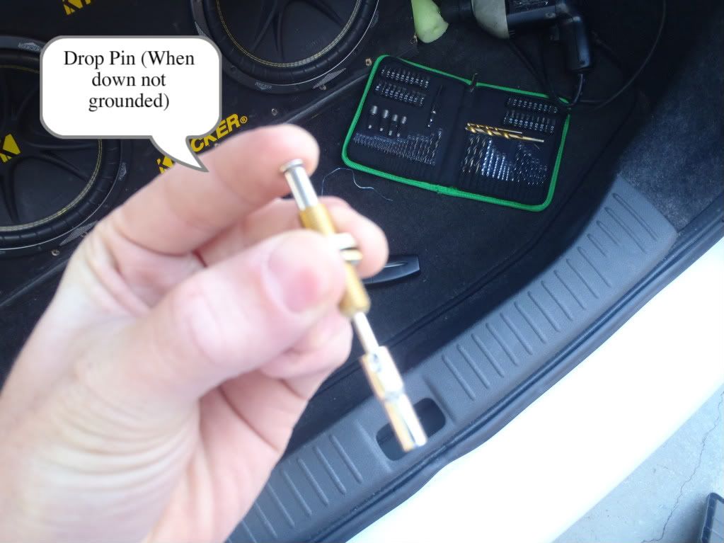

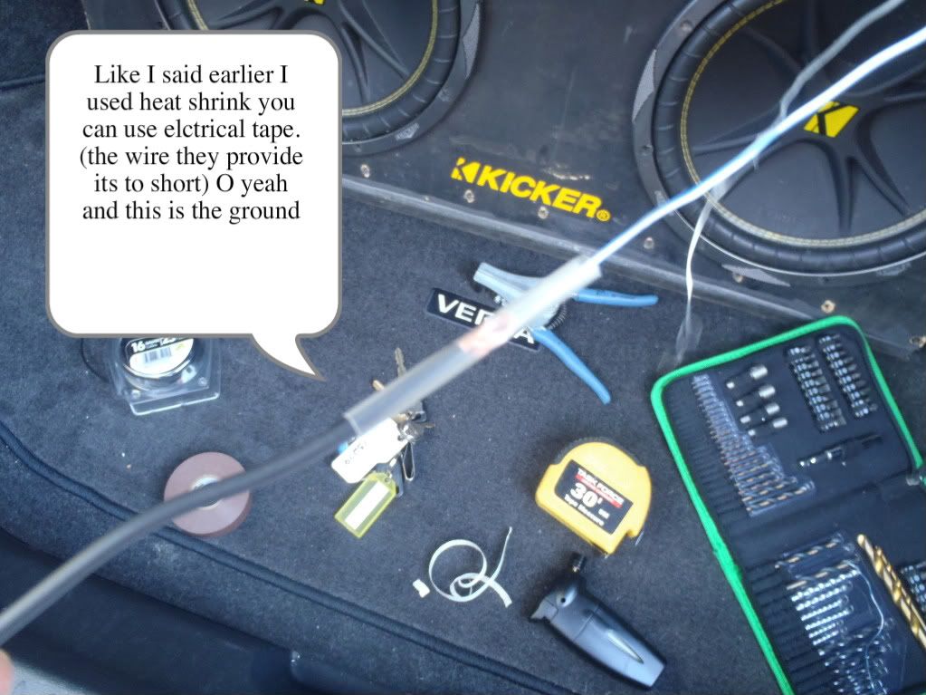

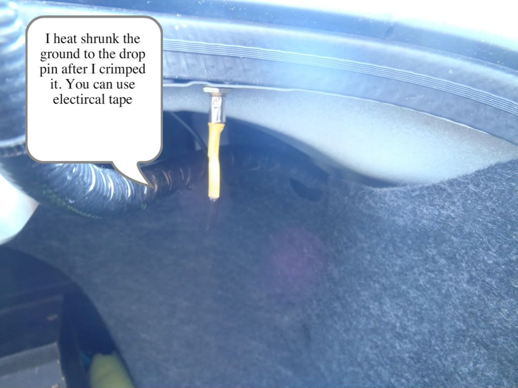

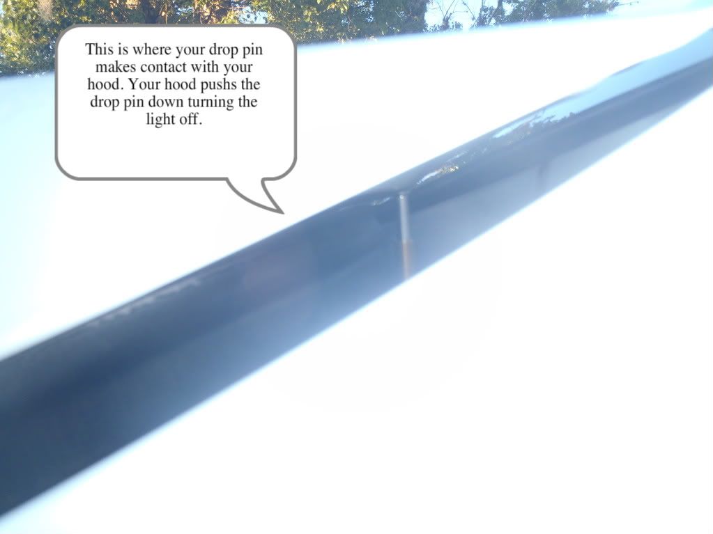

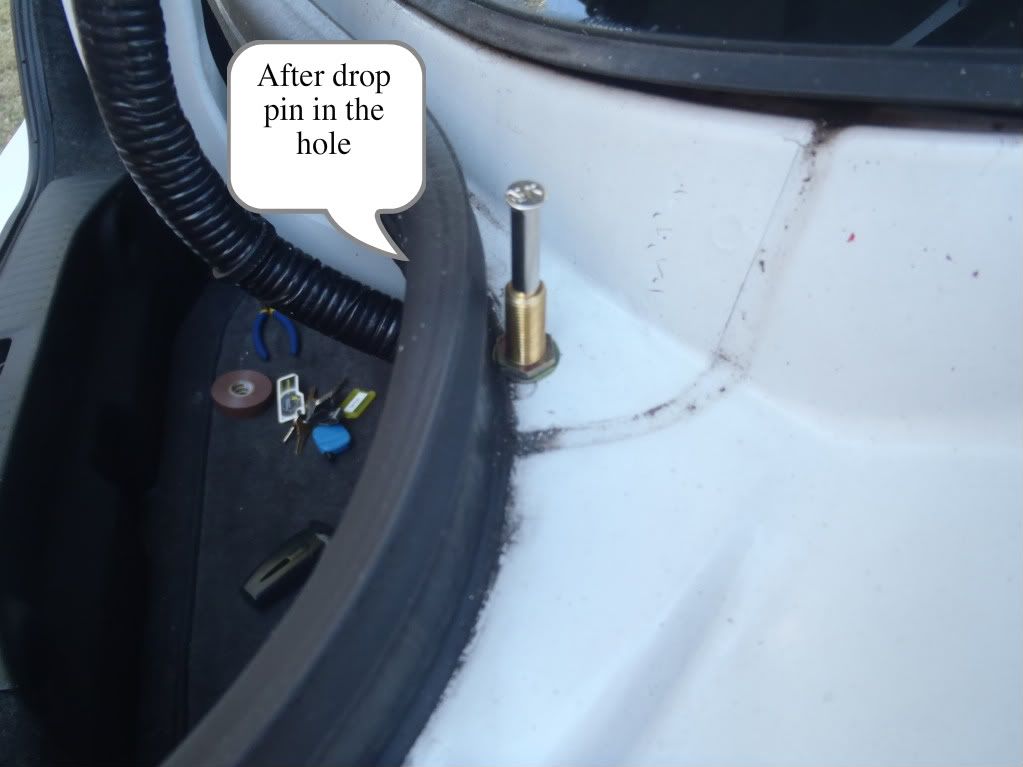

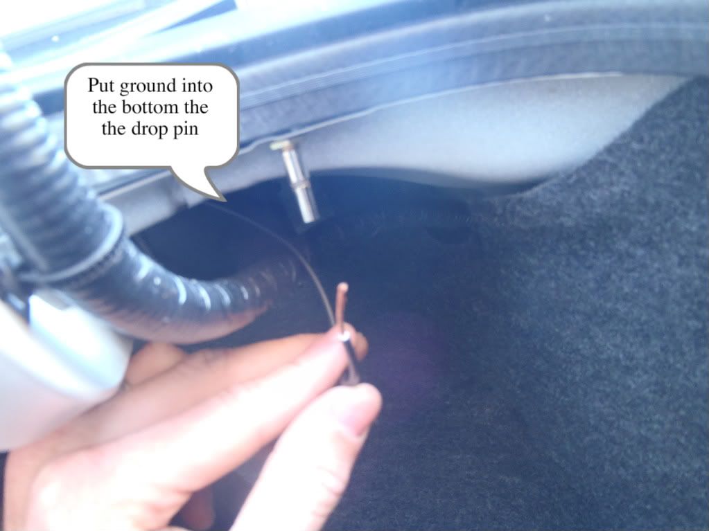

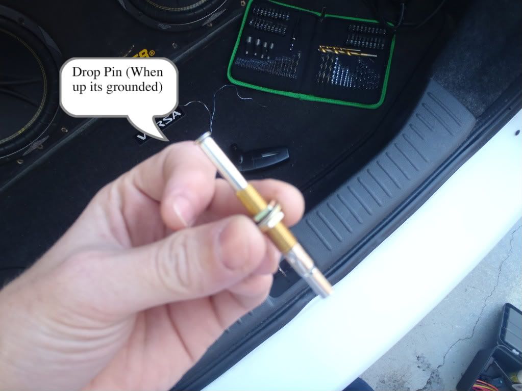

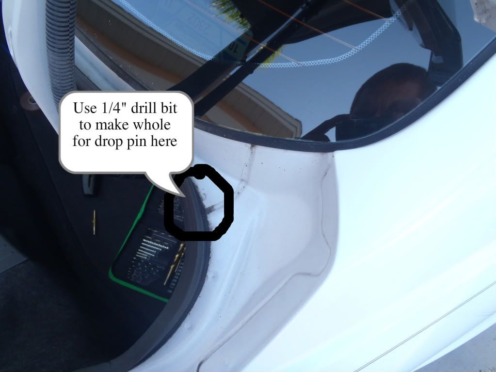

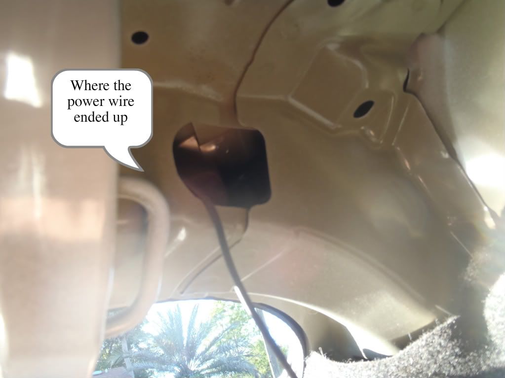

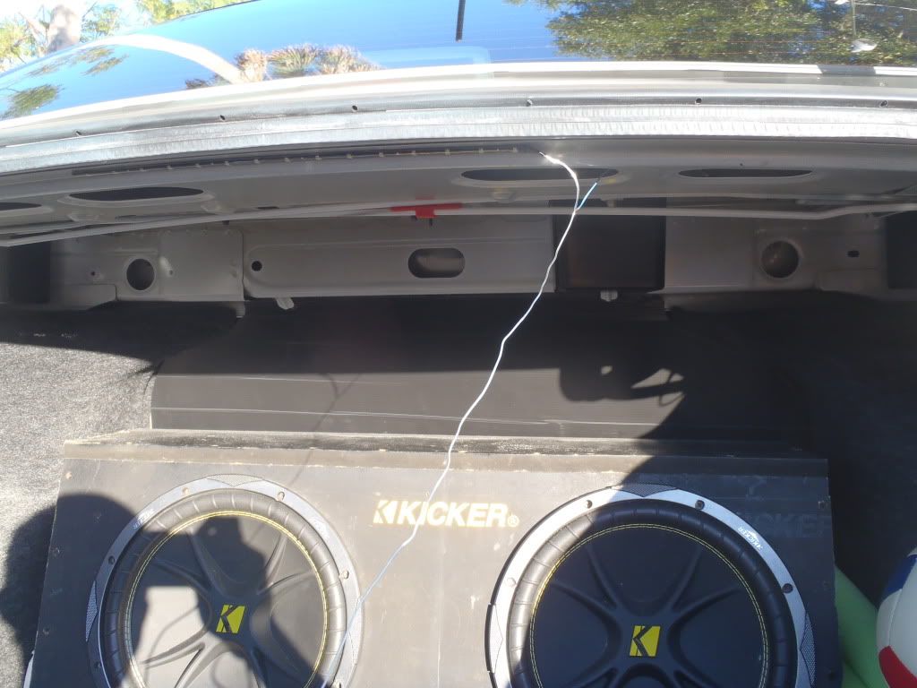

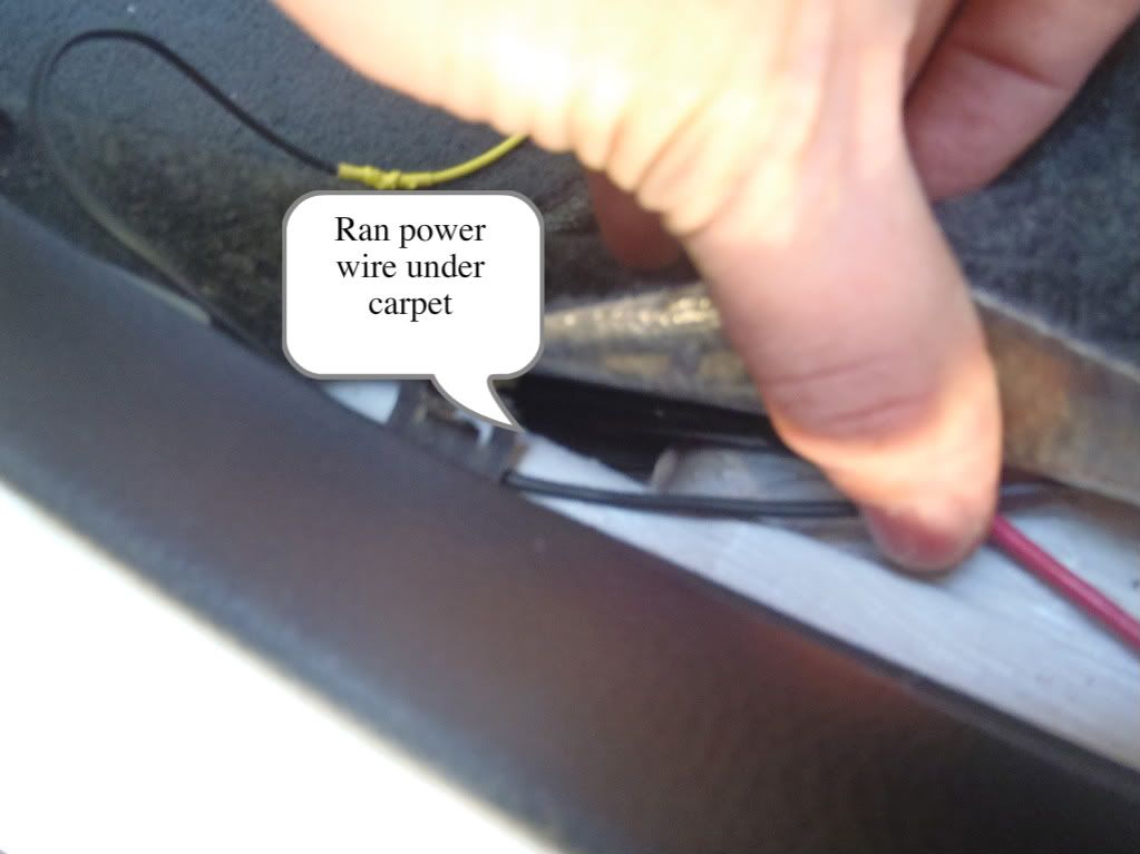

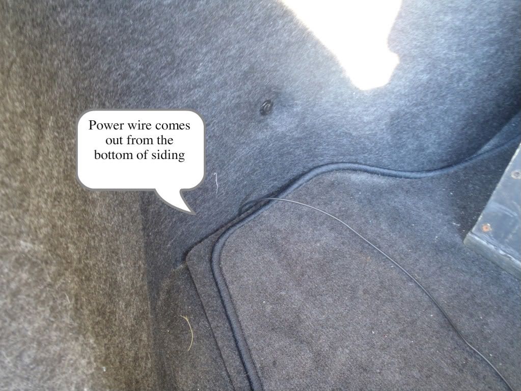

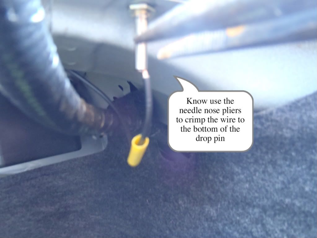

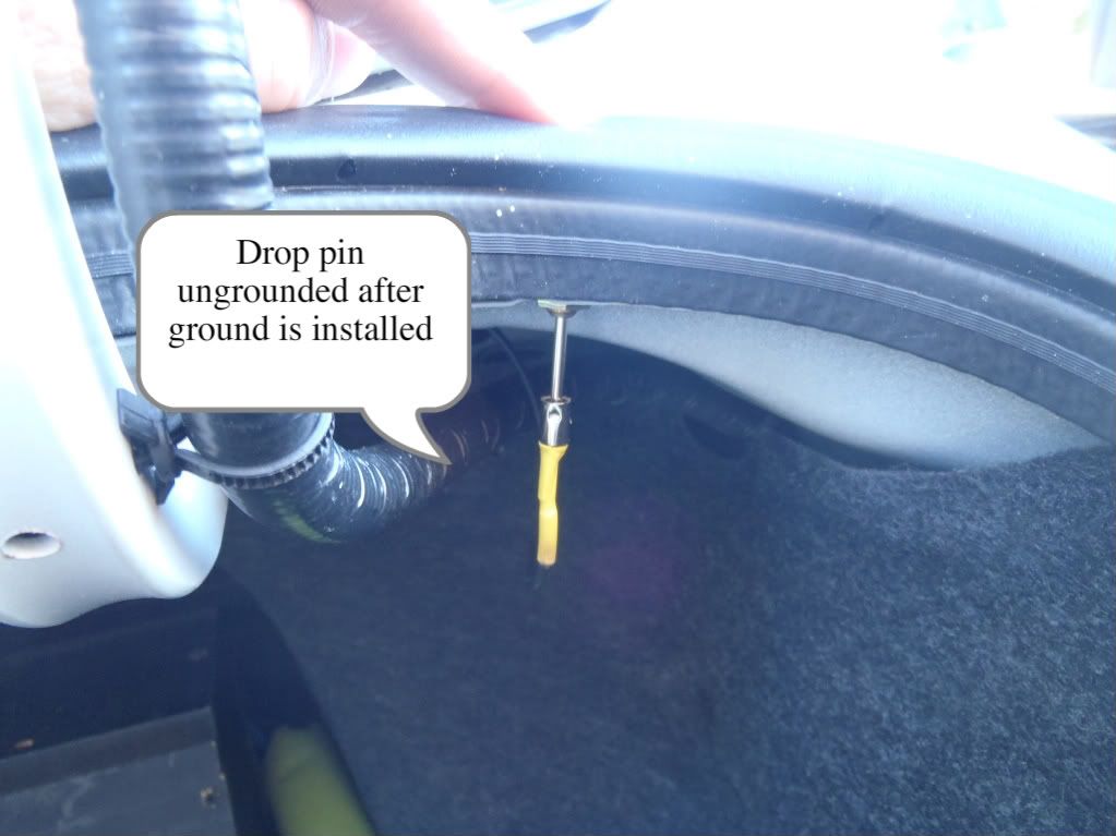

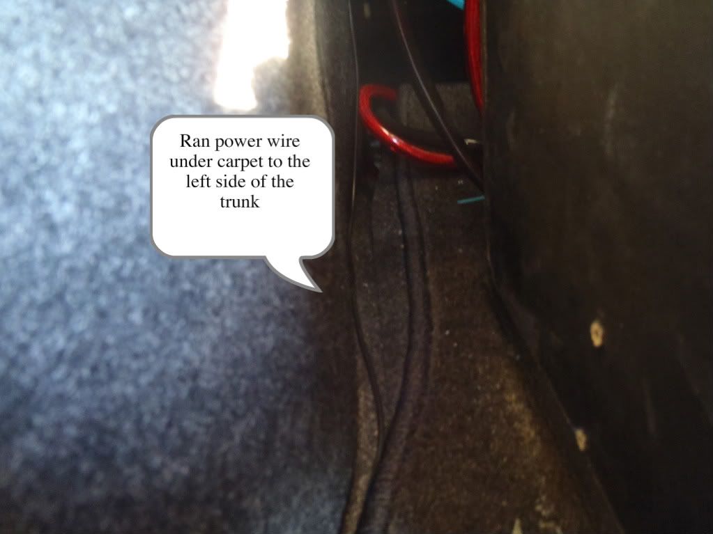

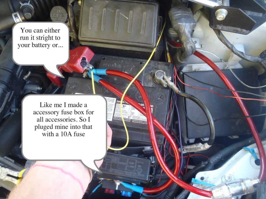

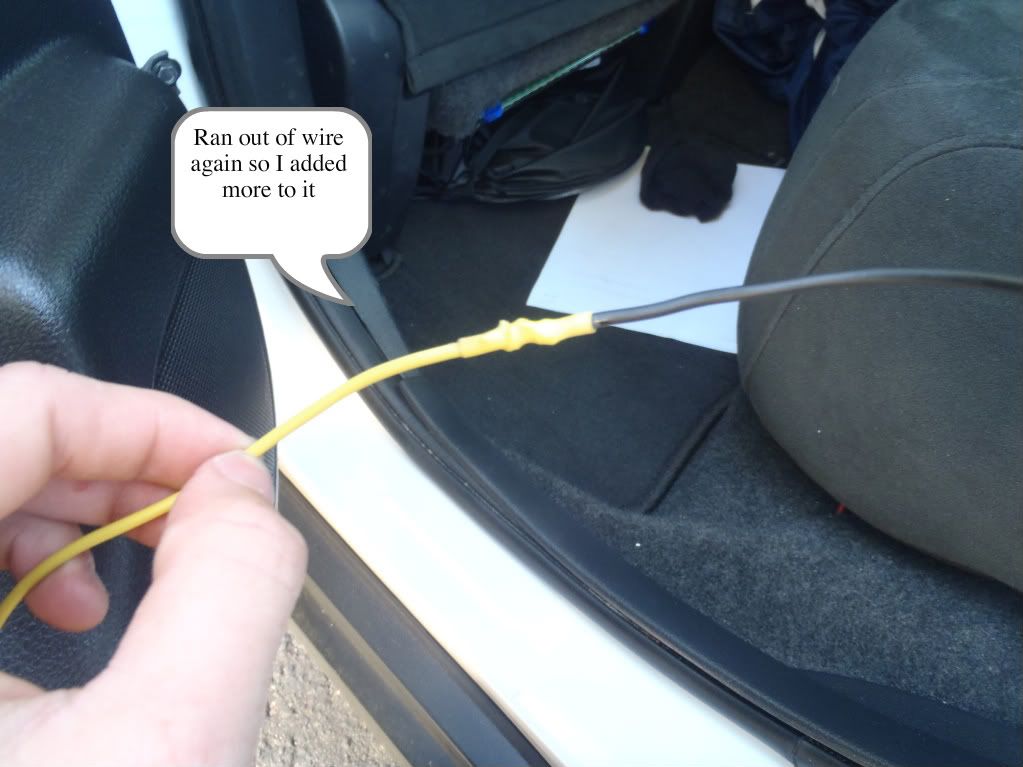

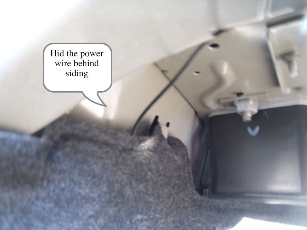

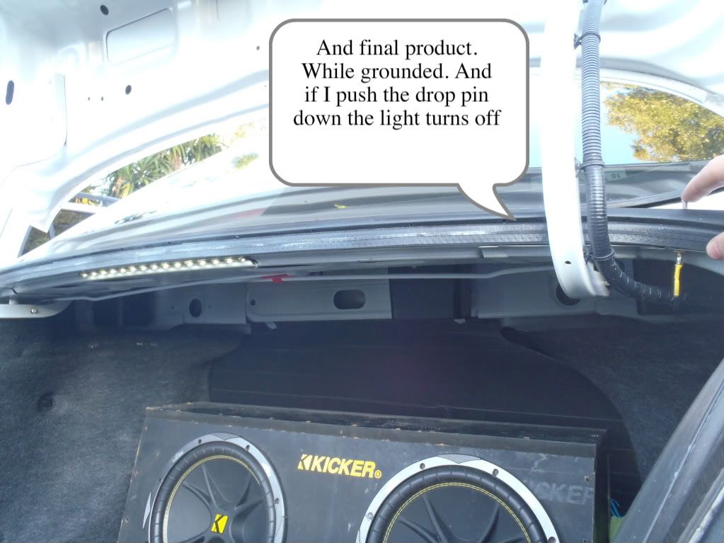

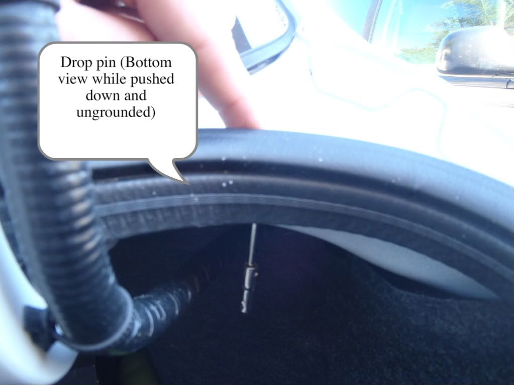

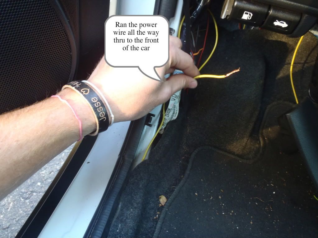

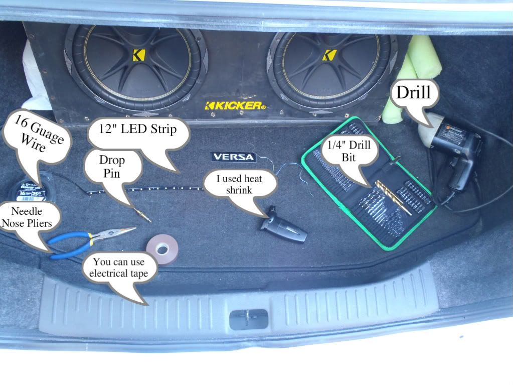

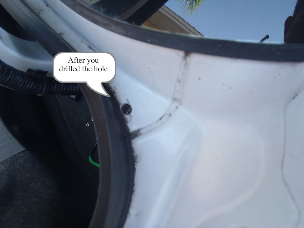

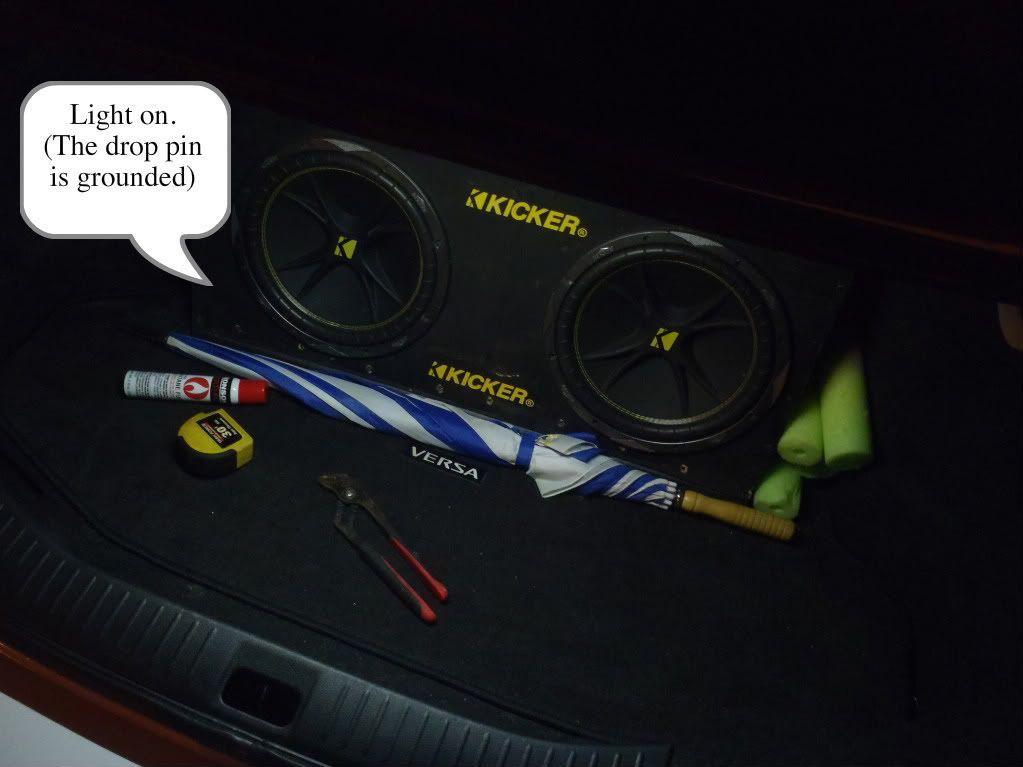

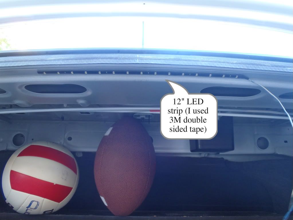

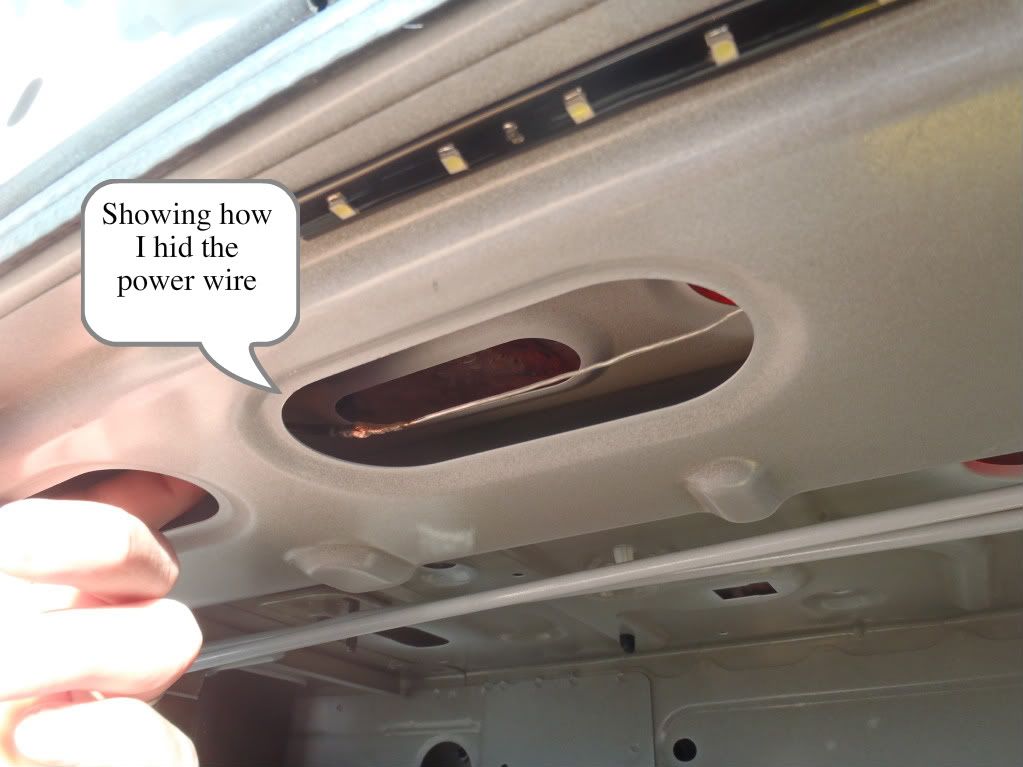

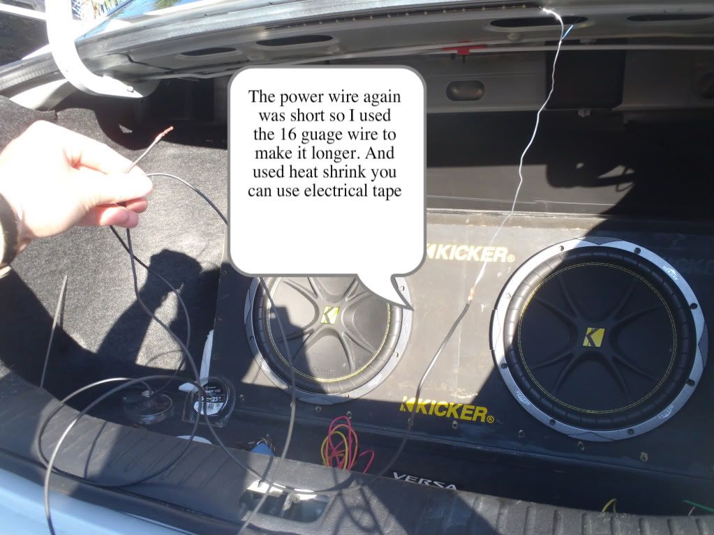

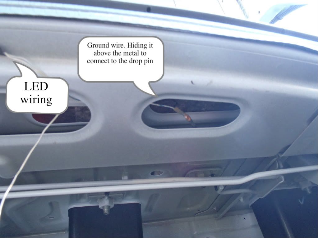

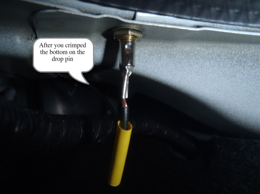

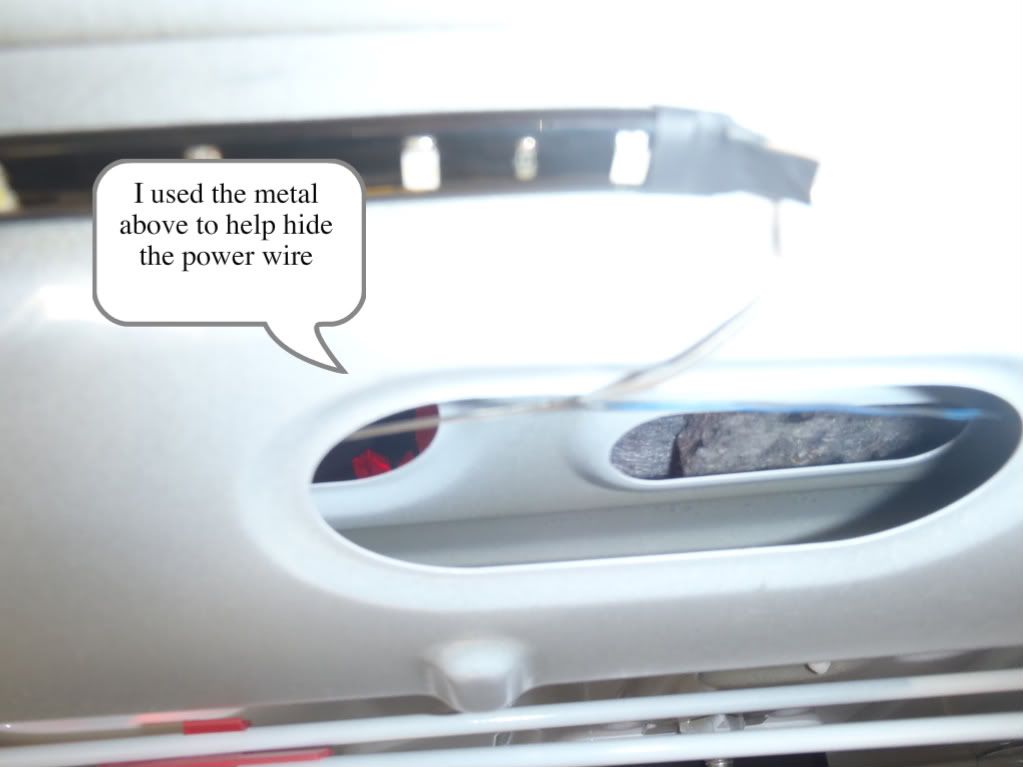

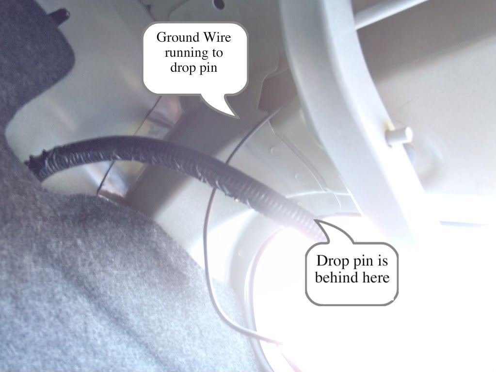

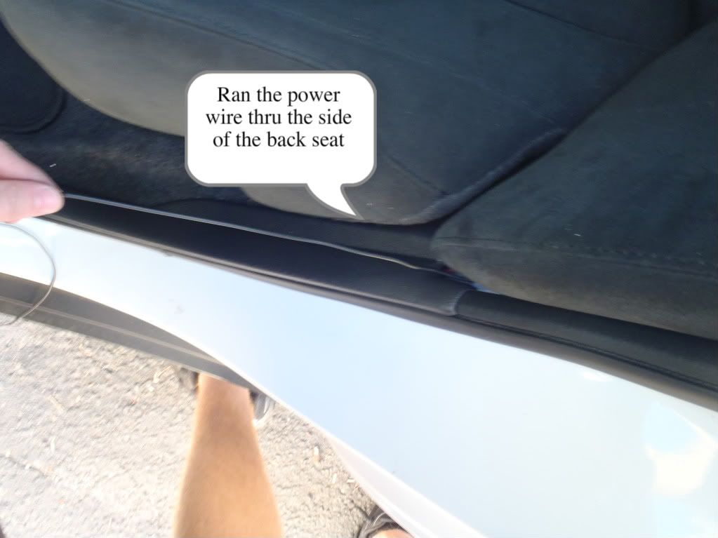

Hey everyone today I decided to install a dome light (meaning when the trunk closes the light turns of and when the hood is open the light turns on) into my trunk of my sedan. If anyone else wanted to do the same I hope these pics and captions help alot. If you need any help dont be afraid to ask.

Couple of questions..
How did you seal the ground pin hole against water intrusion?
Can we get a better picture of your accessory fuse block that you made your self? (Maybe a How to on that?)

Discussion Starter · #7 ·
Thanks guys. I havent yet sealed it becuase it was such a tight fit. But what I might do if i notice there is water coming thru I will use silicon n just put it around the bottom or top of the drop pin. But I will take pictures of the acc. fuse box today and post pic tonight.
