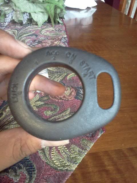

The ignition facia simply slides out by pulling outward on the edges.

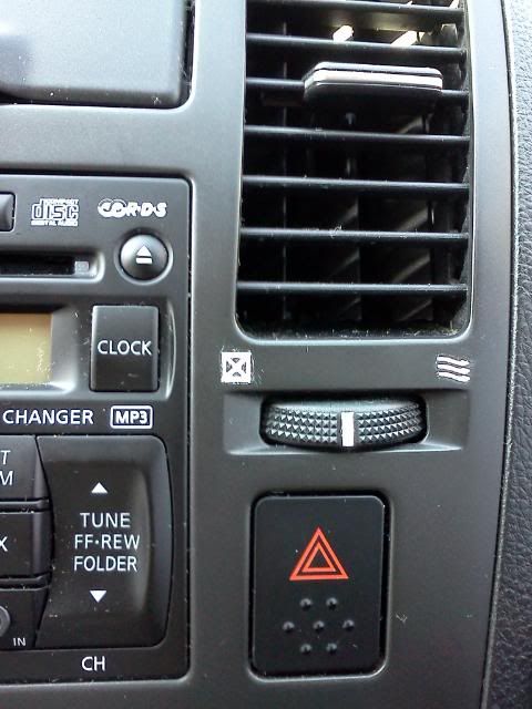

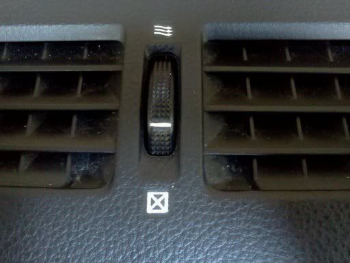

Here is one of the vents prior to painting.

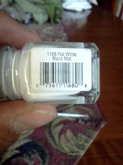

Here is a shot of the Testos paint that I used. I used the flat white to close match the paint on the door locks and steering wheel buttons.

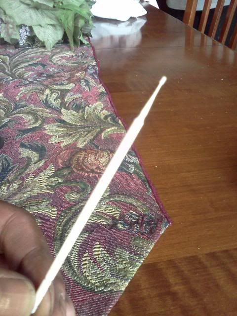

Here is a shot of the super fine tip paint brush. These come in a box of 10.

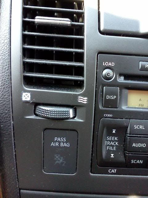

Here is a shot of the top vents after painting. I waited about 60 minutes to let the paint dry but not so much that later it will be difficult to remove the excess paint with with the knife.
I took some time to scrape off the excess paint from the recessed impressions.
Here is the other vent wheel painted and installed.

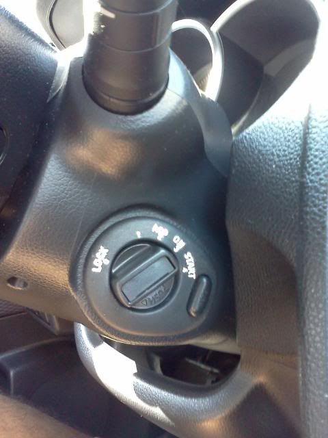

Revised photo of the ignition switch.

The left side center vent.
Right side center vent.
