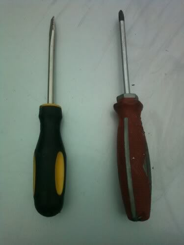

to take off the doors all u need is a flat head and a phillips head to take off the door so lets start

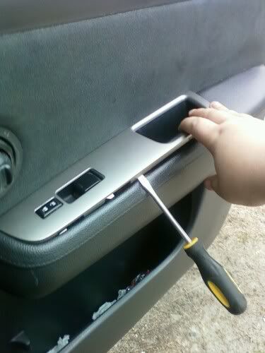

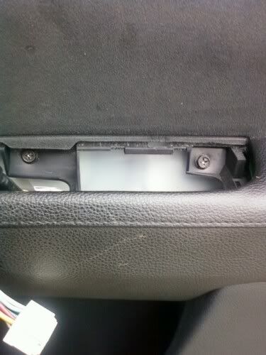

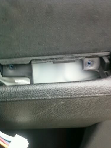

now take the flat head and put under the c looking cover and pop up slow and then take it

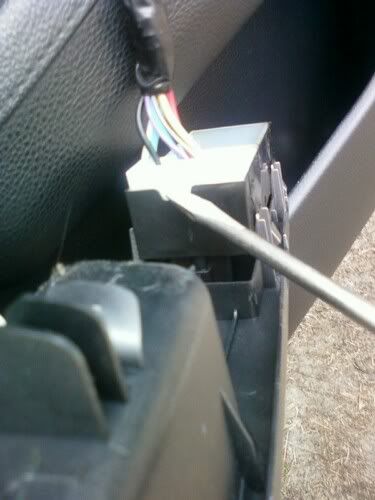

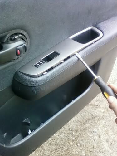

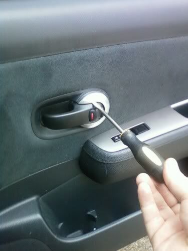

now take the flat head and stick it in the crack of the switch and the door like so
now take your hand and pull it out

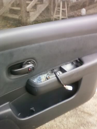

now once you have it off take the flat head or your finger and un-plug to take it off

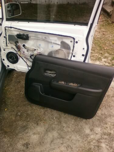

now when this is out the door has to phillips head screws and take them out

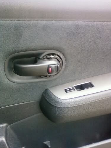

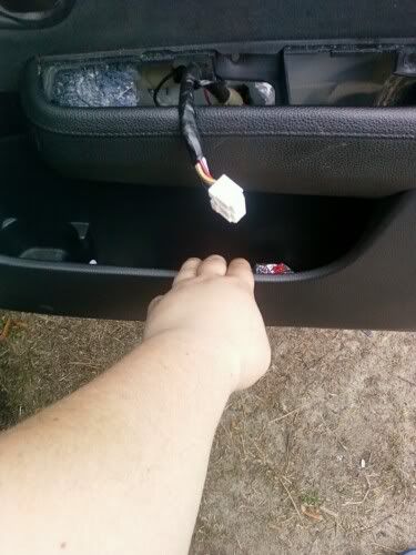

now u can take the door off

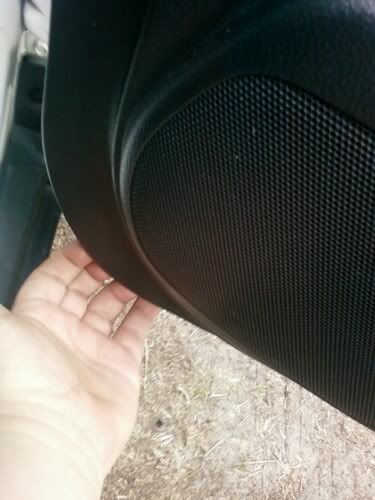

now take your hand and place on the part where my hand is and pull up slow and it should come off with no problems at all
then u can also grab from this spot as well
now once that is done u have this

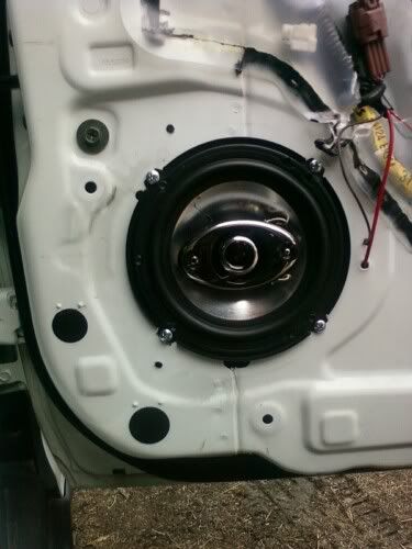

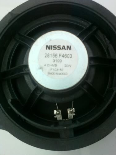

now u can take out them lil 20watt speakers
and get some 600watts like i did

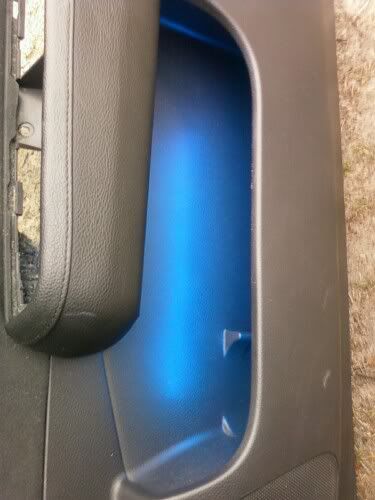

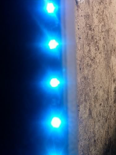

or even wire some leds in the door like so

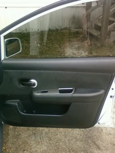

and now to put back on the door do the same steps backwards

Ok. I'm having a hard time with the window switch connector. What part needs to be disconnected. The entire white square? I got the arm piece off the rear door. Now question is if I rip my doors apart can I still put the window back up using the front master driver switch? Or should I wait to tackle this project when I get home.
6,544 Posts
I took one of my rear doors apart. My goal is to refabric it by tomorrow so I can have my door working by Tuesday. Right now my window is down and has to stay down. Lol. I'll post pics later. The worst part was taking the window switch off.
1,206 Posts
Its just a tab that u press and the whole white connector comes off. I normally just push on the tab, while pulling lightly on the whole piece so the wires are tight. And when I push the tab in, it just pops off. before u do it, roll ur window up. If u dont, dont worry, just pop the window switch back on, and roll it up. Its very easy ashley, and dont worry about breaking anything. Its kinda hard to break anything but those silver trim pieces. I broke two of those, cause I didnt know how eactly they came off. lol

Sooo to install those speakers did you drill the door? I have spacers on the way that should work...but I am confused...looks like you drilled through to run wires through as well. I really wish I could find a speaker harness adapter but it doesn't look like they make it so I'm stuck cutting and stripping and crimping...but you didn't use a spacer at all?
