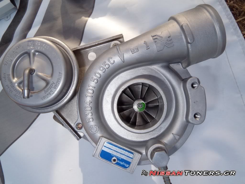

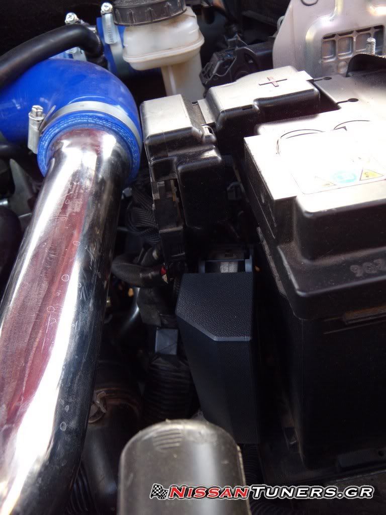

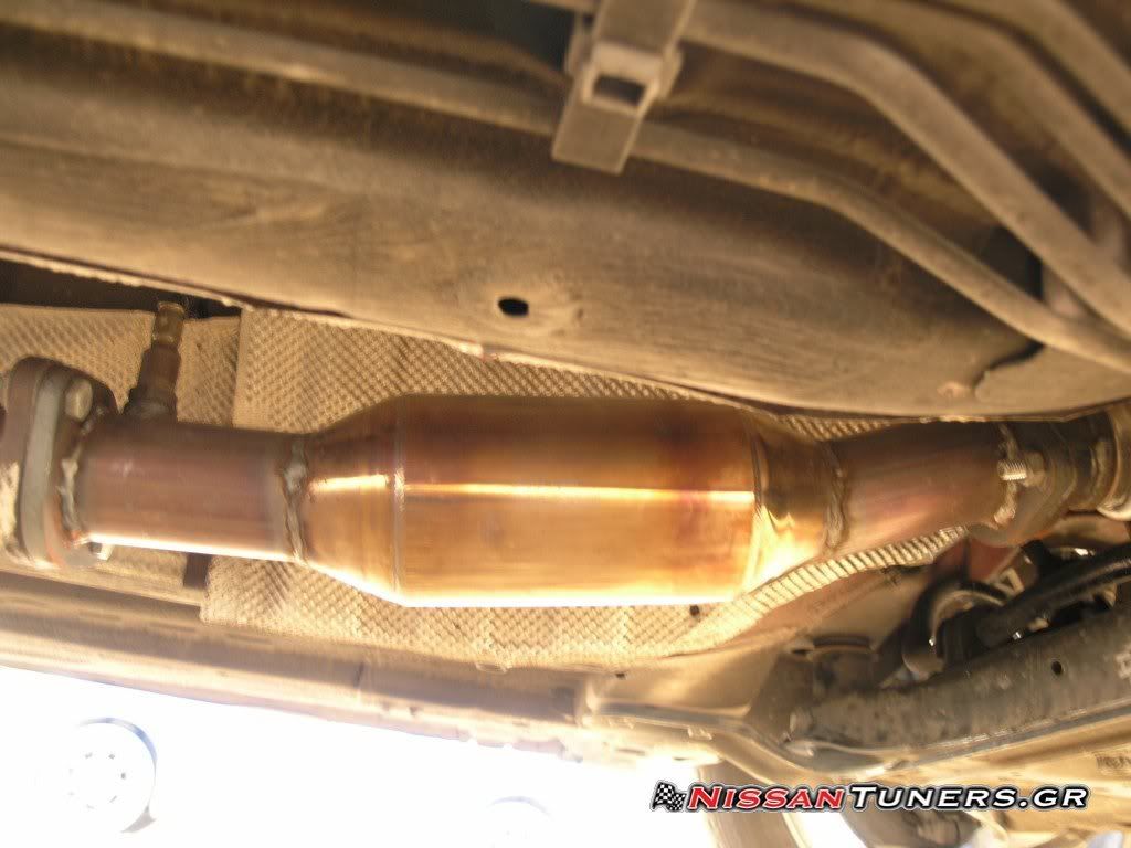

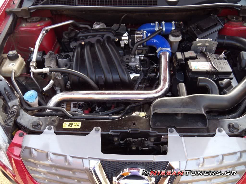

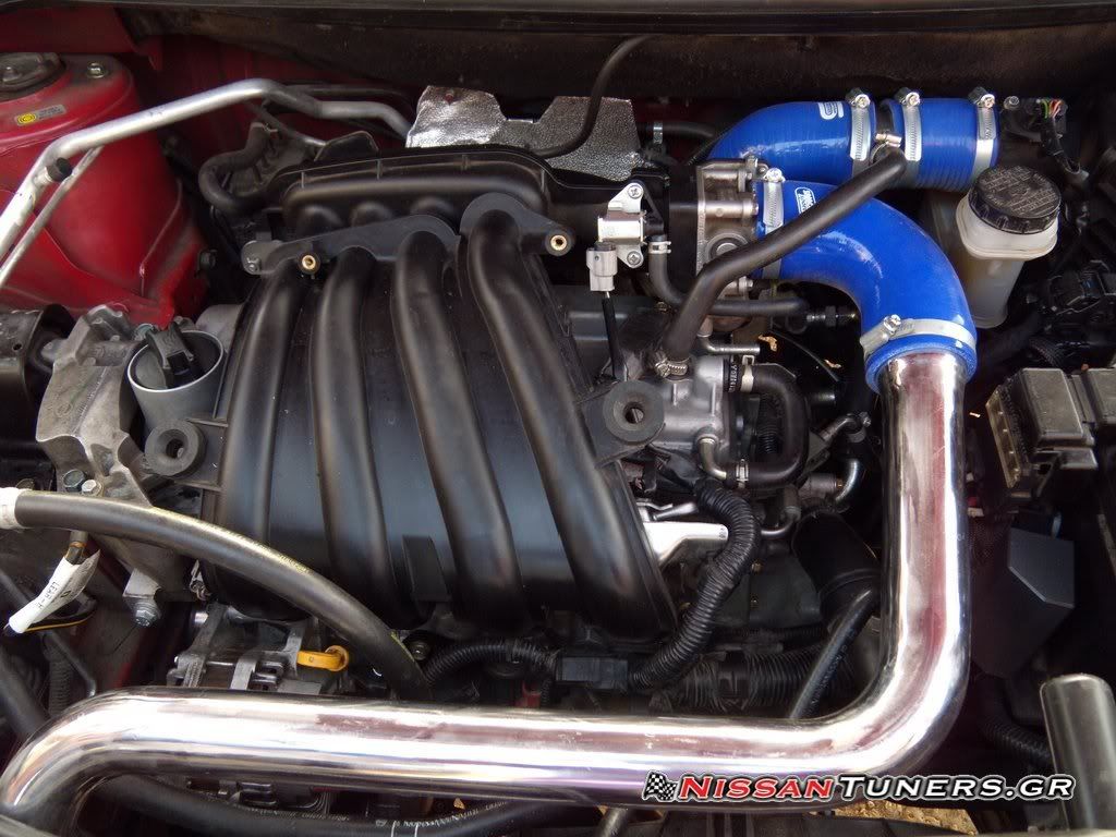

I saw that a Nissan dealer in Greece put together a turbo kit for the HR16DE. I have talked to them before, and they believe it will also work on a Versa/Tiida. Not sure if it will work with newer-style HRs, though. Figured I'd post up their kit. I told them about our forum, and maybe they will chime in. The kit, I'm sure, is pricey, in the $3k range, I bet.
It made just under 150 brake horsepower. Not sure how much you want to make or how much the stock internals can handle, but I've turbocharged another Nissan, and that car was sold running at 218k miles. There are tons of fits and Yaris running turbo on stock internals. With a conservative tune, I doubt you will have too many issues. But if the boost bug bites and you turn the psi up, I'm sure you will blow up the little engine that could.
The vehicle ran at .3 bar (4.5 psi).

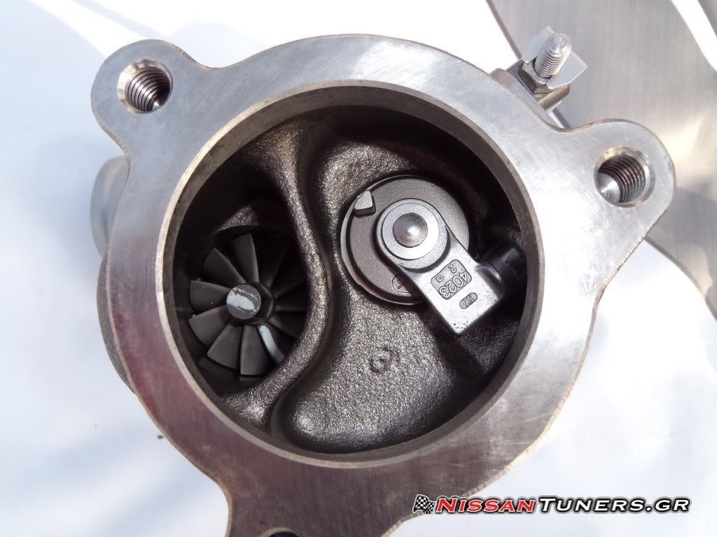

Looks like a KO3 from a VW... Those are good numbers for only 4.5psi, do you know if it has any supporting mods? I would like to it see with with full exhaust, intake, and 10 psi.
I think it was all stock besides the turbo. Even used the stock airbox. More info can be seen here but you need to use a translator. Δοκιμή: Qashqai 1.6L light turbo by Nissan Κυριακούδης

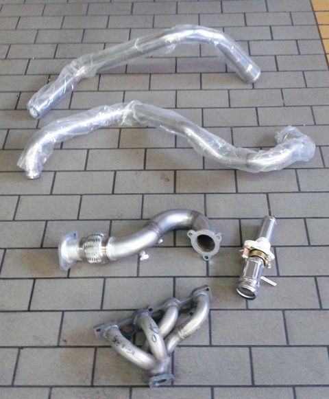

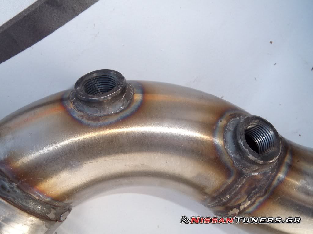

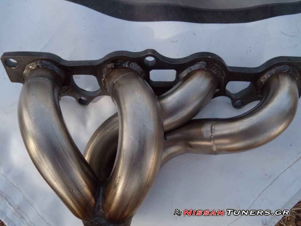

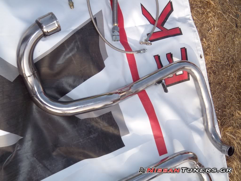

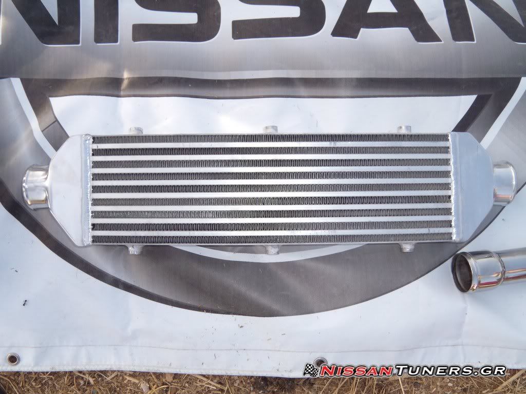

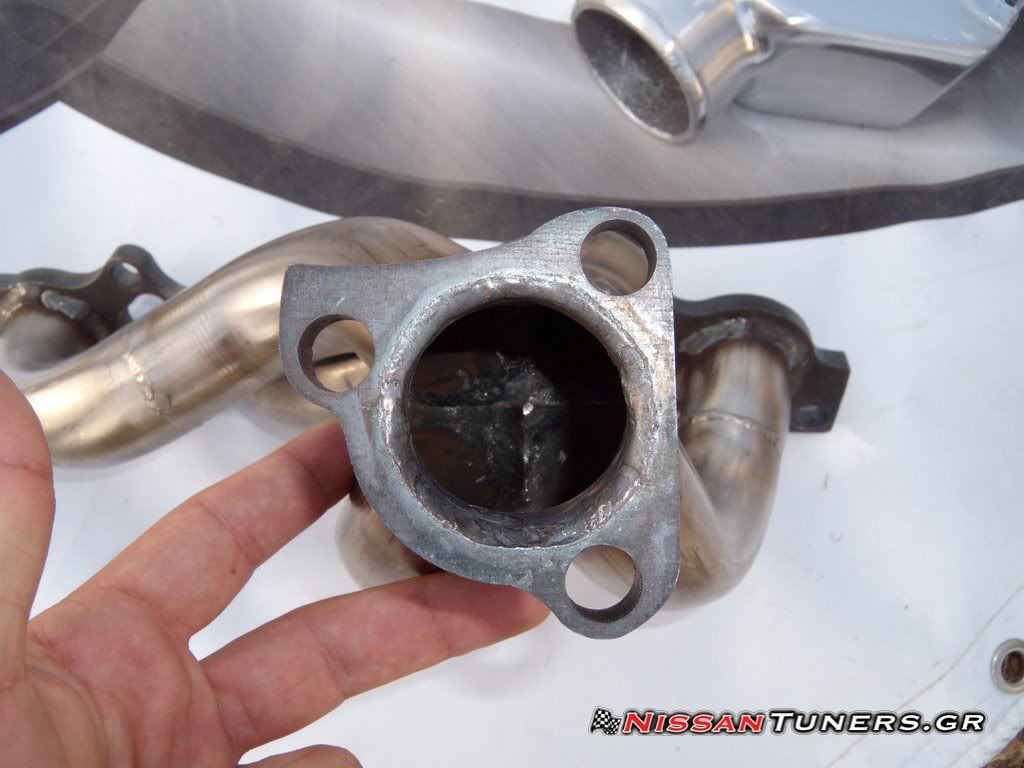

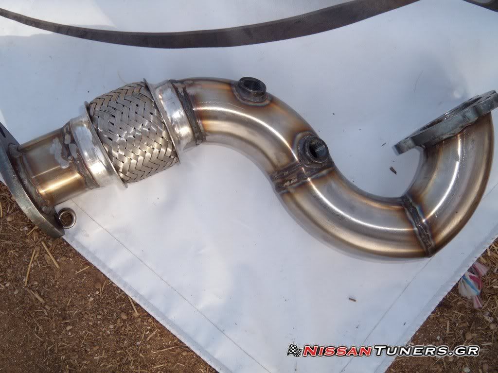

I got another email as far as pricing goes. I asked for the whole kit price and price for just the manifold but he gave me a price on IC pipes, manifold, and downpipe. Might be a little language barrier there. But those are all the custom pieces in the kit. So really everything besides that would be off the shelf.
Hi,
The total cost for the exhaust manifold, down pipe, and intercooler
pipes is 800€ with VAT. In order to calculate the shipping cost you have
to give me your address.
Thanks a lot.
Apostolos Kyriakoudis
I'm emailing back with my address to figure out shipping. I'm assuming it's going to be close to $1500 USD for those parts to an address in the US. Pricey
Discussion Starter · #19 ·

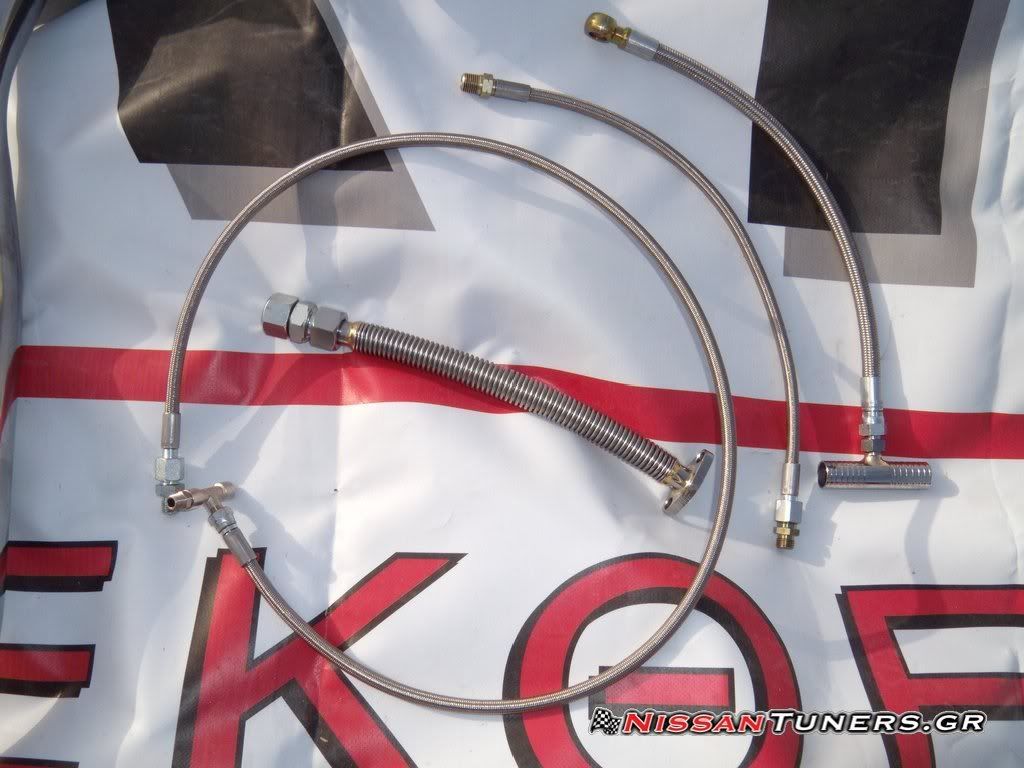

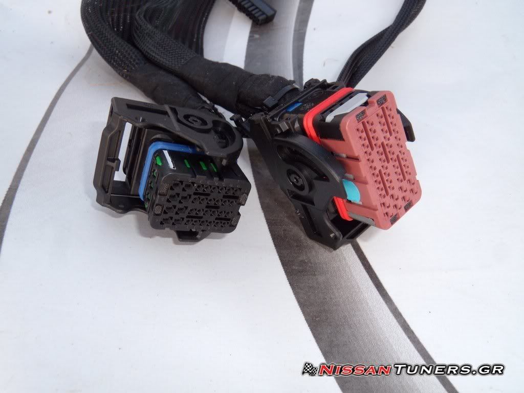

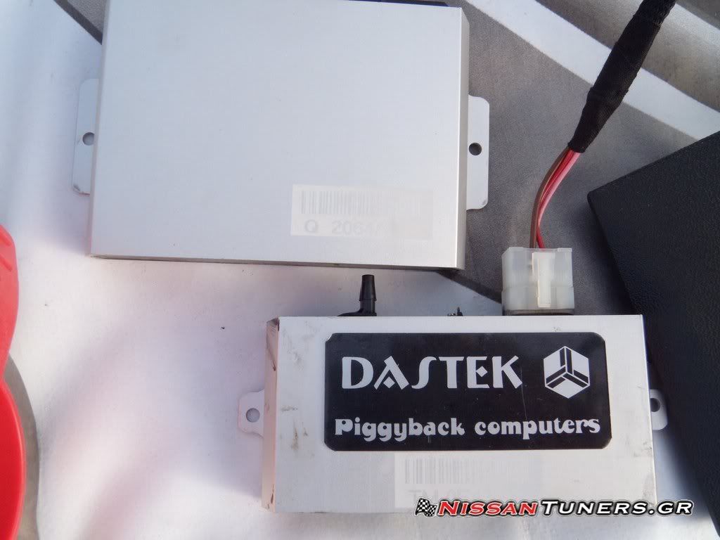

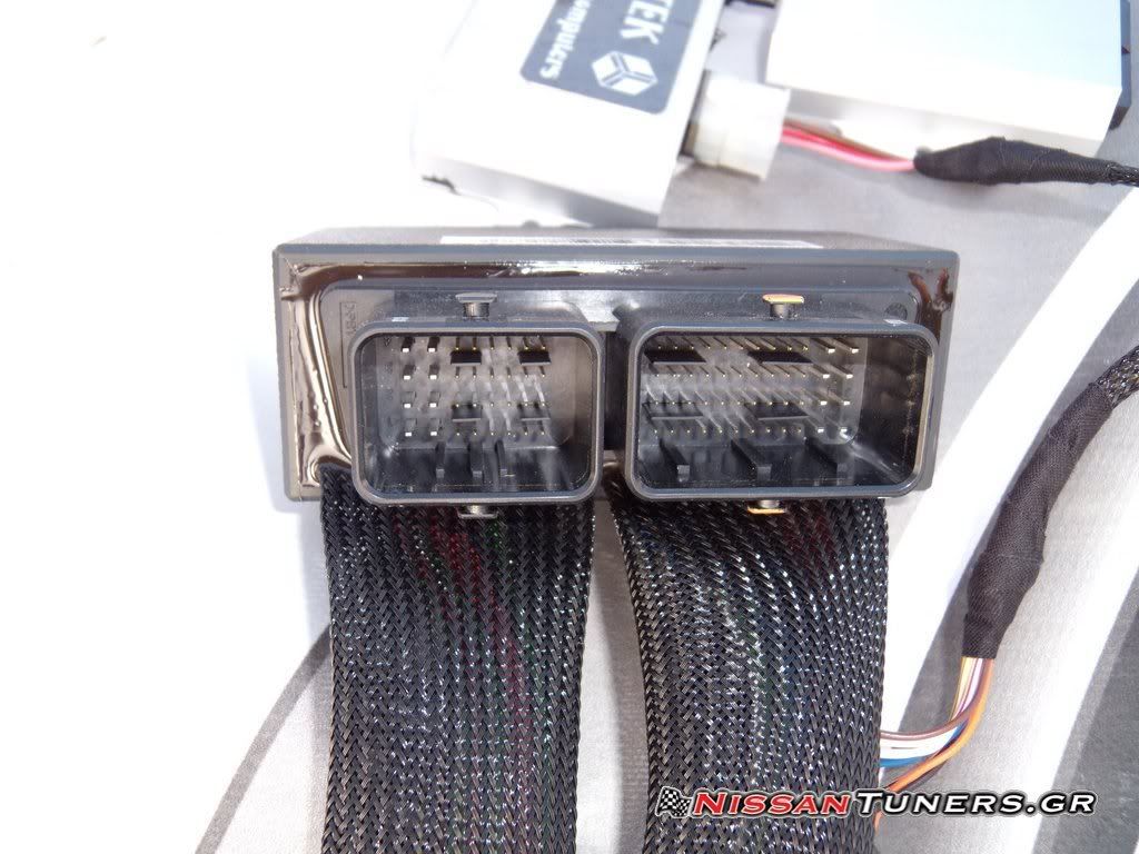

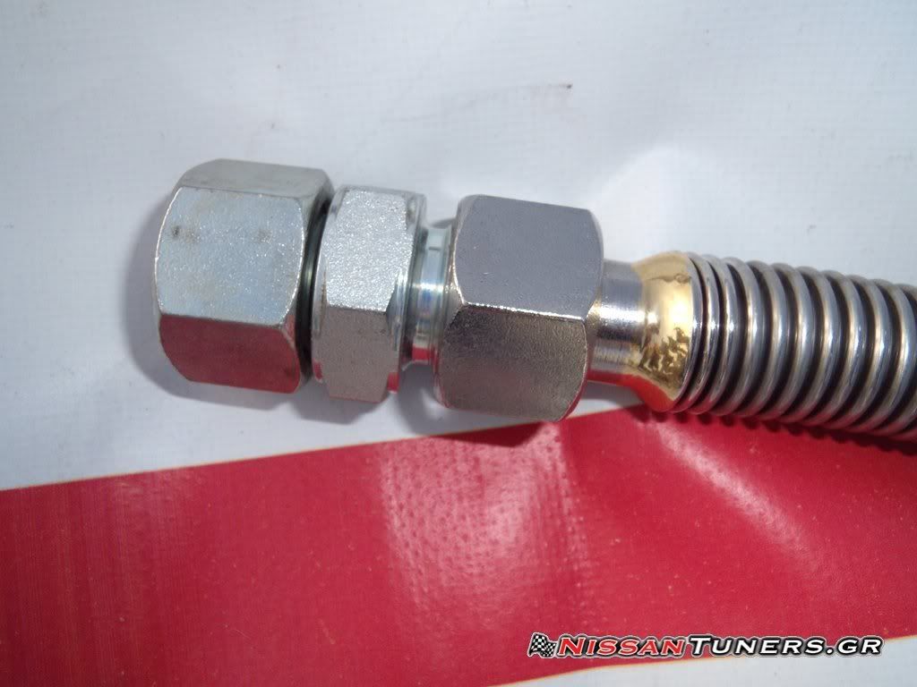

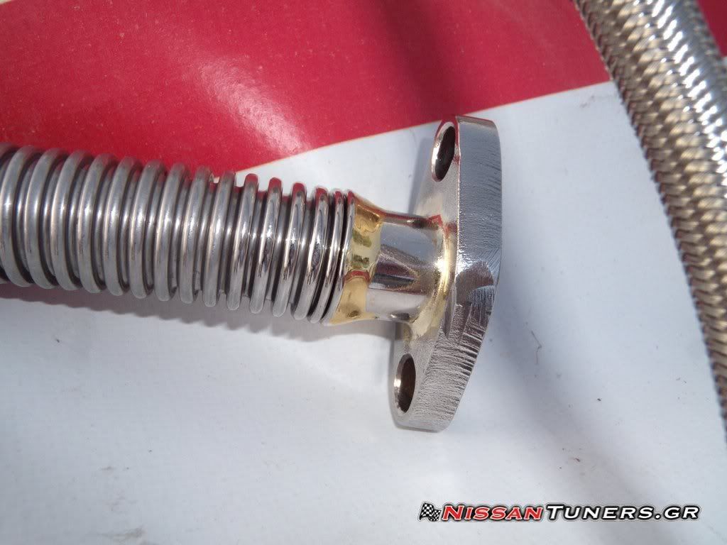

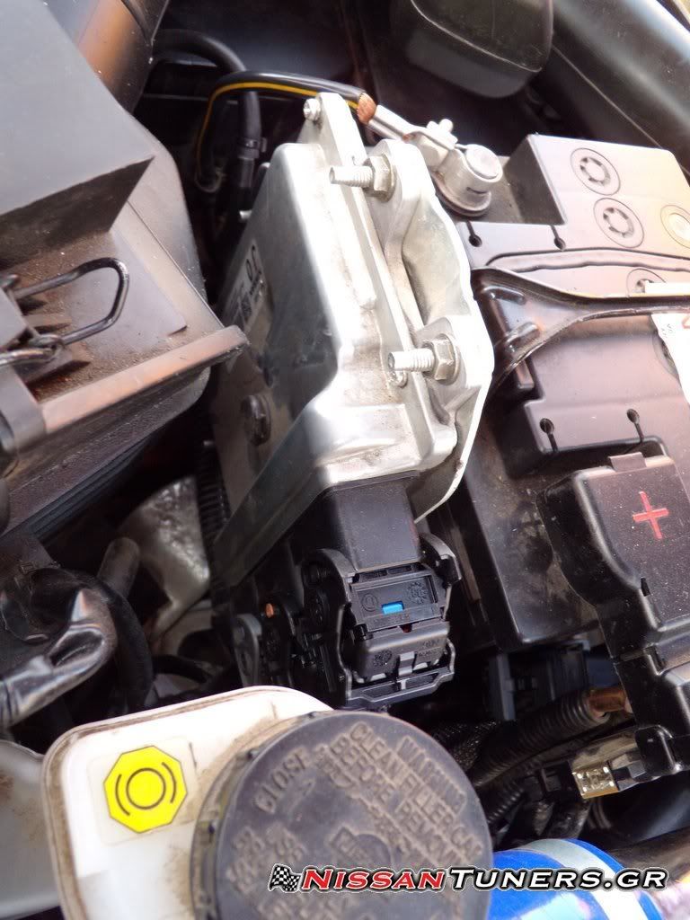

He responded
Good morning
The shipping cost is 150€. I have attached a photo of the kit.
I would like to inform you that I have already modify several HR16
Qashqai. Some of them have run more than 100.000Km after the
installation of turbo without any problem.
Thanks.
