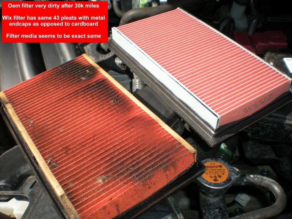

I highly recommend anything made by wix. Everything I have gotten from them seemed top notch.
Here is a comparison pic from my airfilter howto thread showing quality of wix filters. Granted this is air and not incabin filter but I'm just showing how they are quality parts and in this case superior to OEM.
