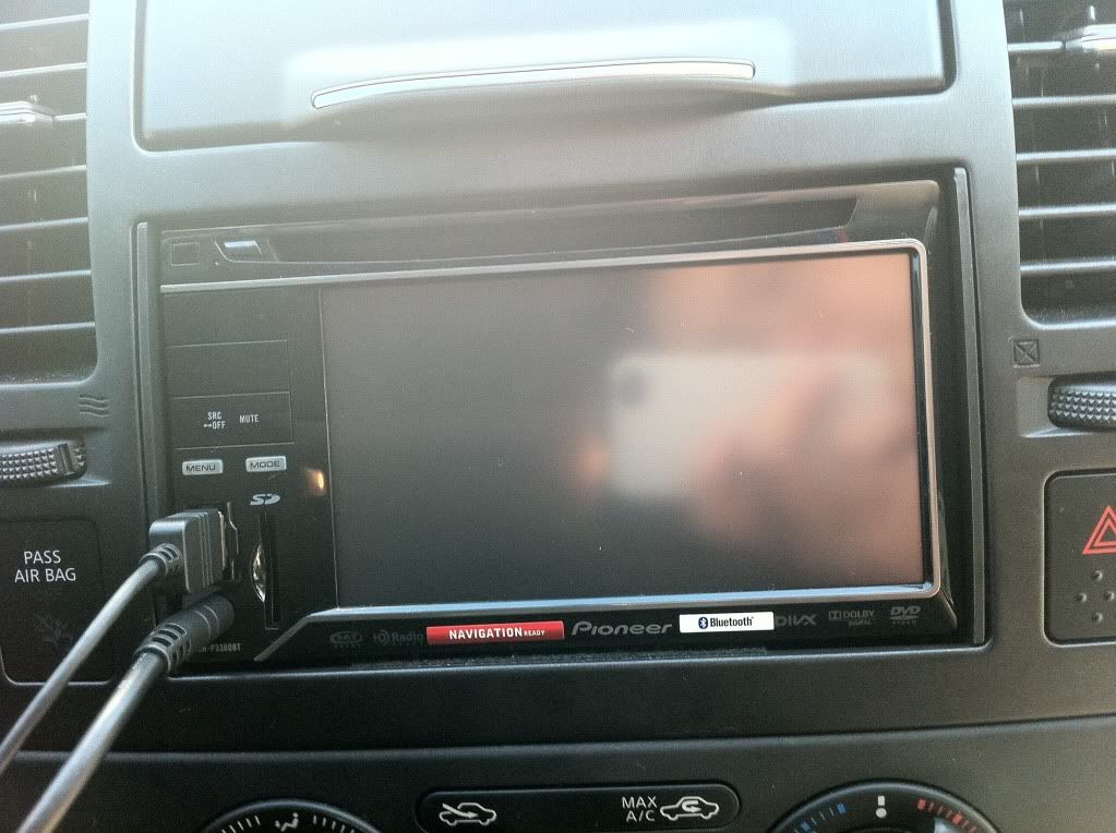

Ive got pics of it in my versa and sentra. Here's what mine looked like.
installed it today!
one problem i noticed though is that my subwoofer isnt working :s
and i didnt install the axxess steering wheel control cause i wasnt really sure how
round 2 is on friday to install the xm radio(didnt have time today) and the axxess
anyone have any tips on the subwoofer and the axess module?
Well the sub. Did you connect the RCA hookup for sub out? Antenna lead for the amp turn on(blue wire) Fuse good to the amp? speaker hooked up inside the box? (Dumb i know, but happens)

Oh ok, you have the stock 8" sub. It was powered off your old deck. I'm not overly sure about how itll work now. Call your local car audio shop

There is a brown wire in the Versa's connector, just connect it to the blue/white wire coming from the Pioneer. This wire (brown) is the factory turn on wire for the subwoofer.

do you know which brown wire specifically?
theres 2 in the main connector that goes into the adaptor to the pioneer
and then theres one connector thats not being used that has one
