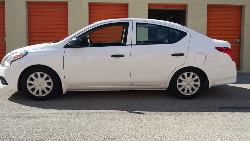

That's right, less than 1k miles and I've already modified my suspension. I purchased a set of used (barely) 2014 sedan springs to modify. I ended up cutting about two full coils out of the front for roughly 2" of drop, and one coil out of the rear for about 1.75" of drop. With a full tank of gas, it sits like this.
Now I know some of you will flame me for running cut springs, but honestly, the stock springs and struts on this car have way more height and travel than they need. The ride and handling are actually improved now, in my opinion, and the car feels much more planted on the road. Highway driving is much easier with the lowered ride height, cornering is better, and the struts/shocks do not bottom out. Until there are coilovers more readily available in the USA, this will have to do.

Looks good man, fist time seen the n17 2015 sedans dropped.
Looks good, much better than factory. :thumbsup:
Thanks Grizz - I was contemplating purchasing coilovers from a new company called Gecko Racing, but ultimately decided to start building an air ride setup for this car instead. The cut springs get me a more acceptable ride height in the meantime. :wink
Thanks Josh - I responded to your PM.

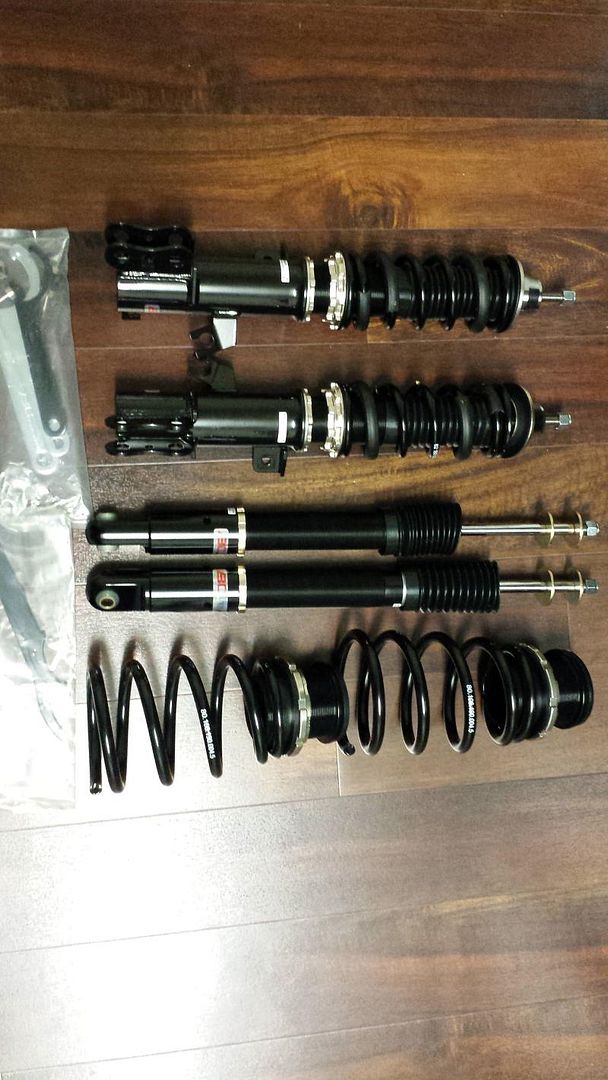

Alignment showed minimal change in toe and almost no change in camber. There isn't much available for this car stateside in terms of performance suspension. I did, however, receive these bad boys a few weeks ago. Just waiting for warmer weather to put them on. BR Racing BR Type Extreme Drop. >:D

What Product # are those Coilovers?? BR racing? HADNT heard of em with Versa Coilovers

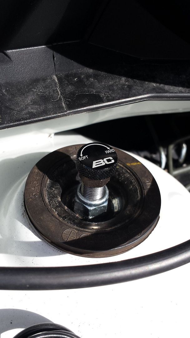

I contacted BC Racing to have these built because I wanted the "Extreme Low" option, which essentially gets you an additional 20mm of height adjustment on the front end. You can contact them through their website, tell them what you need, and they'll set you up with a distributor. I got mine built for the same price as the Megans.
  • Like
Reactions: 1
Also, I had to negotiate pricing through a BC distributor here in the Midwest, but the coilovers actually shipped to me direct from the BC factory in Taiwan.

BC's are installed. I'm still working out the ride height I want. A 3.5" drop front and rear makes the car appear to have reverse rake, even though the rear has more ground clearance than the front. I think this is due to how high the fenders are cut up front. I may actually have to take a couple locking collars out of the front to get it down low enough.
