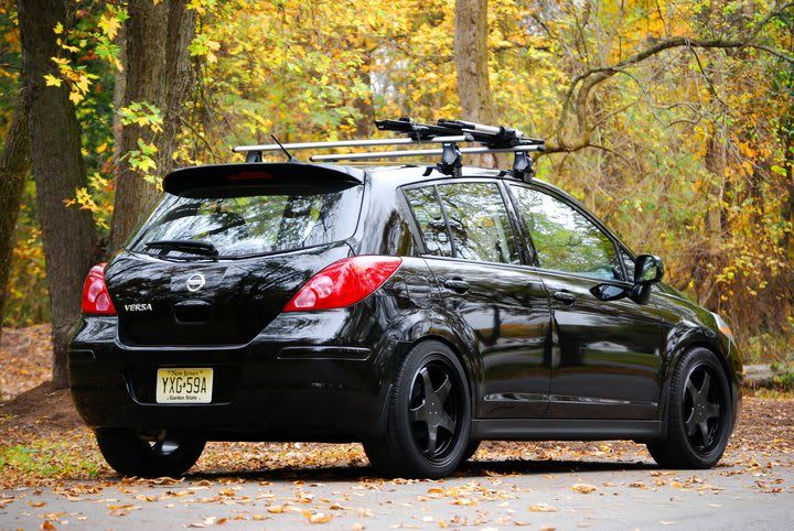

XXR 962 18x8.5 et35 with custom made centercaps
235/40/18 Front 245/40/18 Rear
Tanabe NF210 with 3/4 of a coil cut in the front. I need to cut more to even it out with the rear.
It will only rub with 4 people in the car.
This setup is pretty much perfectly flush. I didnt want to go with stretched tires unless the car is slammed.

Discussion Starter · #12 ·
You just have to really watch out for bumps & pot holes, but I live in jersey and the roads are far from smooth so if I can handle it, anyone can ha. I've had this setup for about a month so far, no major issues with suspension or anything.
