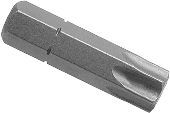

A: The FSM calls for a 50 Torx to be used to remove the entire tensioner pulley assembly but all of my 50Trx
tools are too large to fit in the space ( watch the video to see the crappy clearance)
What tool can I use with a size 50 Torx bit and have enough leverage to take this guy out?
B: Per the video, would you guys conclude as well that the tensioner needs replacing? ( I like redundancy)

They sell both the individual pulley, and the entire unit together, but I think I will go with the ladder. There is nothing really around the tensioner pulley, I think it has a 1 to 1.5 inch clearance before I hit the fender wall so I need to find some type of torx bit ratchet or something that I can use with an extension to get the leverage to take the part out.
I have a set of those ratchet torx bits, and as I recall, they are not very expensive. When space is at a premium, I use a small breaker bar instead of a ratchet as it saves about 1/2 inch of clearance.
Yeah with this bolt though the bit stick out about 75% so to add a breaker bar to that is not going to work, I tried it and you can get the bar + the bit in there together, much less turn the bolt out :/
VIM Tools HCT1050 T10 - T50 Stubby 1/2 Cut Torx Driver Set, 10 Piece
try using the torx socket with a box end wrench around the hex drive of the torx. You may have to sacrifice one and cut the end off the socket off so its only a hex. Then it can maybe tak welded or quick steeled in place on the wrench
or see if you can get one of these and get a 7/16 wrench around it
How did you remove the belt tensioner?
Wont work, there is not enough clearance for even these small Torx and then a breaker bar
Hey, were you able to remove the belt tensioner? If so, how did you do it? I'm able to try on my 07 versa right now.
Hey,, has anyone found a fix for this besides removing the engine mounts and jacking up the motor....???
Same problem here, i am planning to weld a flat bar and a cut-off T50 bit. I am just waiting for the tensioner kit.
A good way to isolate the issue is to remove the belt and run the car to see if the vibration is gone.
You should be able to use a bit like the one posted above, with a ratcheting wrench. That's about as low profile as it gets. If you need more room, use a pry bar to shove the engine over a little.

I was able to replace tensioner by drilling a hole and use a long Allen T50. aI also had to place jack under the engine to align.
I followed this video :
I'm pretty sure you can just shove the whole engine over enough with a big pry bar to do this job. Push it over and stuff something in there to hold it.
