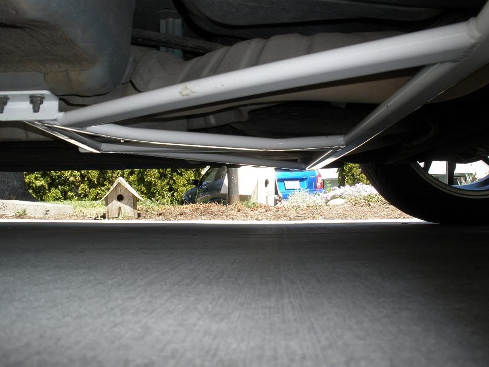

please explain more. Sorry if im asking to many questions.btw there is NOT nuts on the rear bolts.
Question- the under brace you talking about where can I find one..??i installed my front under brace today and i no longer clunk!
i noticed that the bolt that connects the brace is also the mount for the rear of the lower control arm. well the bolt is threaded down the whole thing and the thread were actually wore off in the middle were the control arm rides. with the threads being gone it would let the control arm move about 1/16th - 1/8th inch and cause a clunk.
i went to nissan and ordered new bolts for $4.74 for both. if the clunk comes back i will replace the bolts and go from there.
btw mine only clunked on right hand turns and going over a bump at the same time at almost any speed.
