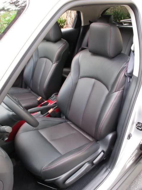

I was at the dealer today trying to get my driver seat fixed but getting nowhere. Anyway, I was looking at their models out in the lot trying to calm my anger down before getting on the road and took a look at a Juke with leather seats. I didn't do any accurate measuring, but I think the front seats will fit the Versa. The railing seems very similar to those in the Versa. I also read that the platform is the same as the Versa. Has anyone looked into this? Here is a photo for your consideration.

I looked at the rails to a juke the other day and thought the same thing.
114 Posts
I really like that red stitch work and the patterns. I will keep an eye out for these at my local junk yards. Houston is blessed (or cursed) with a huge number of salvage yards.

I just found this thread. I'm also curious if these fit. The pic in the first post, the height and recline levers look like my 2015 Versa SV seat. I found a perfect condition leather steering wheel on eBay, but couldn't see paying the $100 seller wanted. Maybe I'll find it in salvage too.
