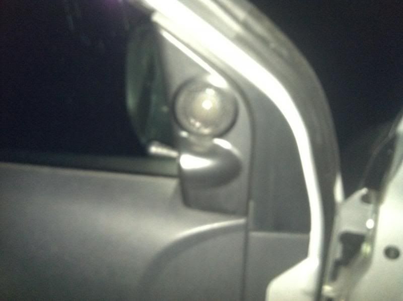

sorry for the not so clear pic, but you get the point. this is where i have my tweets mounted for the time being. hopefully ill be relocating them to the kick pods that i might be making tomorrow
all i did was i found a hole saw that was the size of the tweeter, drilled, and than used a mini torch to heat the plastic, so it would seam more flushed.
I would have never guess to putting my tweeters there kudos! I might pit some there now
