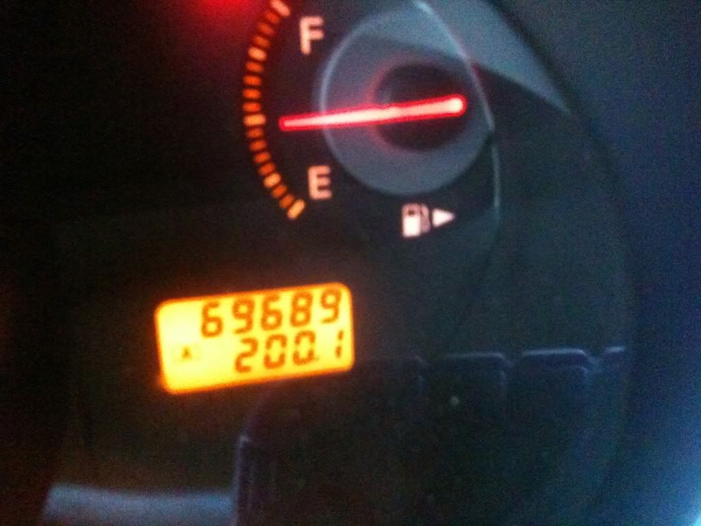

******UPDATE*******
Hit 200miles on half tank, not bad considering its a bigger engine. however I babied the shit out of it, barley hitting the gas. I don't get this good of mileage just driving normal and spirited, just fyi.
