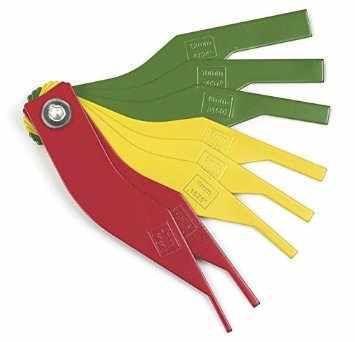

I'd say best thing to do is remove the tire and visually inspect them. If they look low replace them. There's also a brake pad measurement tool that is placed between the pad and rotor to tell give a reading looks like this
For the shoes it would be the same way remove the tire and then the drum to see how thin they are. Shoes generally last longer than front pads.
